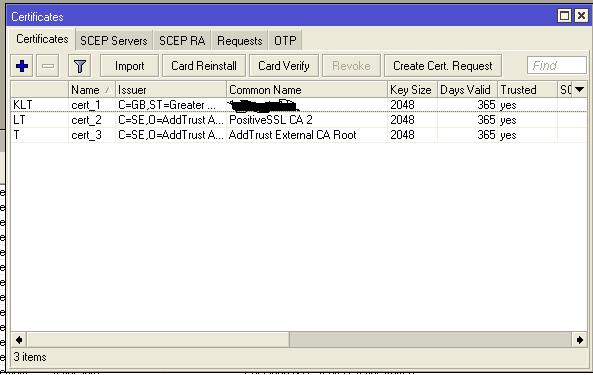

Trying to install A PositiveSSL cert (RB433,435 ROS6.10) for use with Hotspot clients
They’ve sent me three certs :
1: MyDomain cert,
2: Indermediate cert and
3: CA Root cert
I imported all off them with that order and last I imported my private key using winbox
The support-man told me that the common way is to install
my Domain certificate with the key and then a bundle,
which actually is a file containing the two other certs.
Both installations give the same results as in the image below.
They also give instructions for many web-servers but nothing about MT web Server
Is my setup ok?
