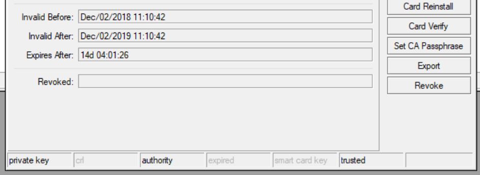

Why there is a difference between “invalid before”/“expires after” ???
See the picture … which one is right ?

Hello
  1. Is this locally generated or imported certificate?
    It is generated locally on mikrotik router
  2. Is Your routers time set correctly and its showing precise time?
    yes, time and date is correct
When i reboot the router, all entries are correct (also the entrie “Expires After”)
Over the time, the value “expires after” is no longer correct.
Its a RB4011iGS+5HacQ2HnD-IN with RouterOS 6.44.5 (Longterm)

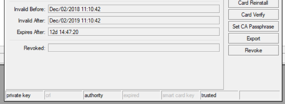

18h later the router shows now:
That’s not correct when you look at “expires after” ?!?!?!?
So my question, when the certificate will expire ?? at the date or after the days shown ?!?!?!?

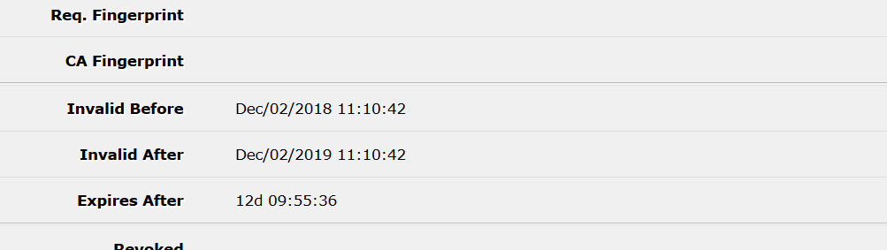

same thing in wegfig:
Screenshot is about 2 hours later … and the time in mikrotik for the certificate has about 4,5 hours past ???

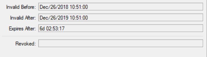

here a screenshot of the client certificate on the LtAP (genrated on the RB4011 and imported in the LtAP)
The 26 Dec. is not in 6 days ?!?!??!!?!?

That is the behavior typical in winbox. Date/time running forward in the future because some offset is doubled or so.
(e.g. "last time up" or "last time down" in interface statistics is a date in the future)
Did not know it could affect webfig too. Try it in command mode.
