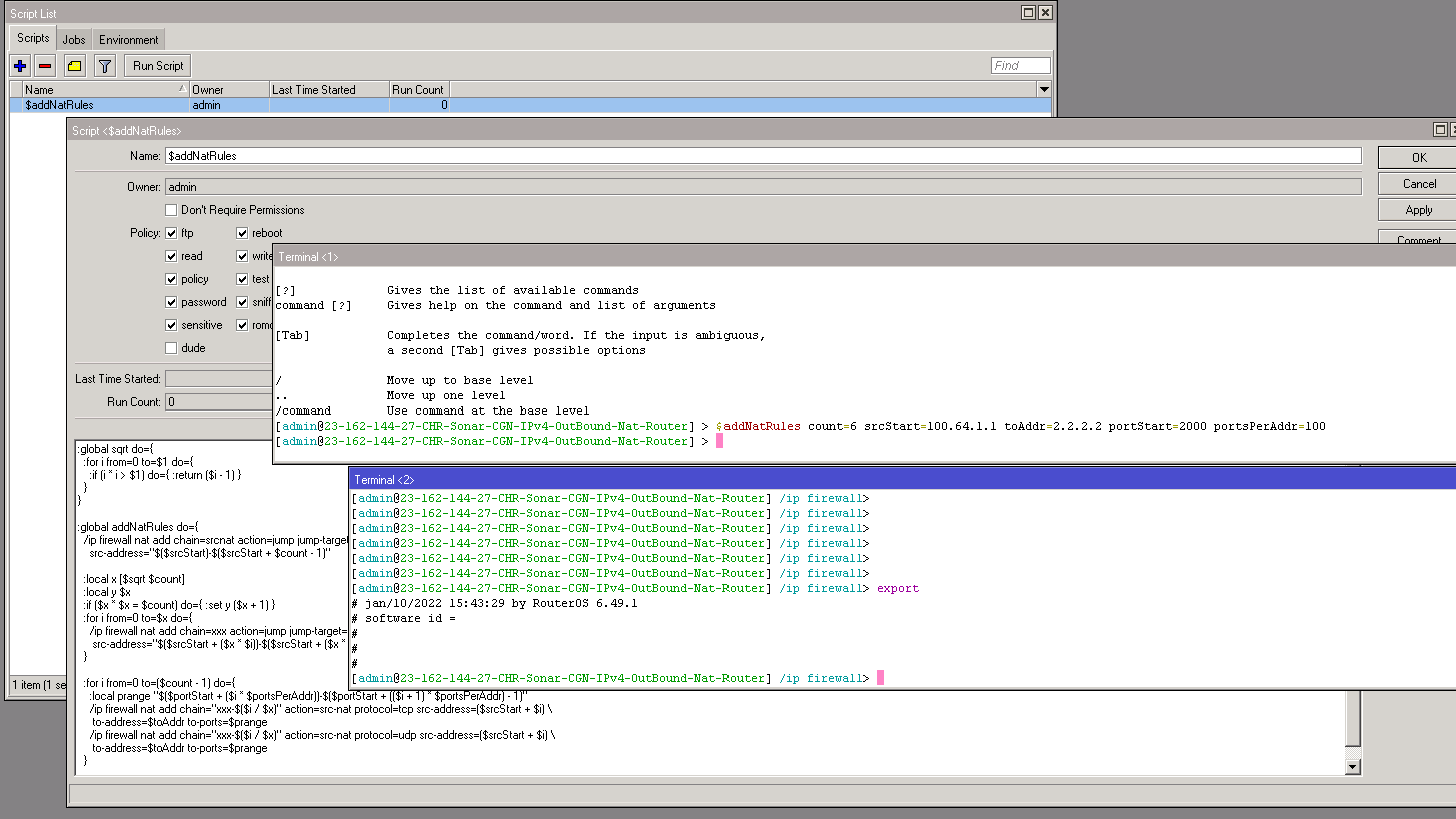

I am asking for some help.
I need to configure NAT444.
I have found several examples to configure NAT444 using a “addNatRules” function.
Example: in the Mikrotik Wiki → https://wiki.mikrotik.com/wiki/Manual:IP/Firewall/NAT#Carrier-Grade_NAT_.28CGNAT.29_or_NAT444
There is a section in the Mikrotik Wiki that has some documentation about using the function “$addNatRules”.
I am having problems running the function ( either I am making mistakes and don’t know how to run configure and execute this function -or- the function is broken/not-functioning ).
So here are my questions:
Question #1 ; Is the Mikrotik Wiki documentation on the function “$addNatRules” correct and does it work ?
Question #2 ; Where can I find clean clear-cut easy-to-follow documentation to create this function and how do I execute this function ?
Here is what I have tried that is failing:
I add a script with the name of “addNatRules”. The body of the script is as follows:
:global sqrt do={
:for i from=0 to=$1 do={
:if (i * i > $1) do={ :return ($i - 1) }
:global addNatRules do={
/ip firewall nat add chain=srcnat action=jump jump-target=xxx
src-address=“$($srcStart)-$($srcStart + $count - 1)”
:local x [$sqrt $count]
:local y $x
:if ($x * $x = $count) do={ :set y ($x + 1) }
:for i from=0 to=$x do={
/ip firewall nat add chain=xxx action=jump jump-target=“xxx-$($i)”
src-address=“$($srcStart + ($x * $i))-$($srcStart + ($x * ($i + 1) - 1))”
:for i from=0 to=($count - 1) do={
:local prange “$($portStart + ($i * $portsPerAddr))-$($portStart + (($i + 1) * $portsPerAddr) - 1)”
/ip firewall nat add chain=“xxx-$($i / $x)” action=src-nat protocol=tcp src-address=($srcStart + $i)
to-address=$toAddr to-ports=$prange
/ip firewall nat add chain=“xxx-$($i / $x)” action=src-nat protocol=udp src-address=($srcStart + $i)
Then at the CLI prompt I paste in something like this ( and the script does not do anything ).
I have tried this with and without the “$” in the script - I am lost.
Related to my question addNatRule
What is a good working amount of ports to use ?
I have seen several documents about addNatRules that show 100 ports and some at 10,000 ports.
So , I ask, what is a decent number of ports that will probably work ( 250 ports per CGN IP address ? ) ??
The script die not work for me, as well.
I ended up using the idea and manually built a binary-tree of cascaded jumps to reduce CPU-Load. (Excel helped here for string manipulation).
At the end of each jump-cascade there will be the netmap/NAT to squeeze down the number of required ports.
For residential customers 1012 Ports (64 customers per IP) are sufficient.
For Hotspot/Wireless users you might squeeze it down to 63 ports per user (1024 Users per IP).
Limiting the ports per user does not mean there will be a hard limit of connections=ports. Mikrotik does port-overloading. This means it can re-use the same port for another destination.
Loading a bloated website full of ads and other stuff on a 63 port NAT resulted in approx. 300 successfully simultaneously open sessions.
Be aware that only 63 concurrent DNS requests are possible, still.

This CGNAT solution only takes care of tcp, udp and icmp.
If you wish to use other protocols, you might need to experiment. Or ad a final catch all rule. (but that might break legal stuff):
add action=netmap chain=srcnat src-address=100.64.0.0/18 to-addresses=3.2.1.0/24
Further optimization might be done using harsh timings with the connection tracking, especially if you’re going to hand out less than 250 ports per customer:
set generic-timeout=1m tcp-established-timeout=1h tcp-max-retrans-timeout=1m tcp-unacked-timeout=1m udp-stream-timeout=10s udp-timeout=3m
To automatically clear hung UDP-DNS-Connections you might find a regulary scheduled script helpful:
/system scheduler
add interval=2s name=Clear-DNS on-event="/ip firewall connection remove [find protocol=udp dst-address~\":53\" timeout<2m57s]" policy=ftp,reboot,read,write,policy,test,password,sniff,sensitive,romon start-date=jun/29/2018 start-time=07:46:54
A final suggestion. Do NOT terminale the private space on the router, which has to do the CGNAT translation.
Create two interfaces with transfer networks.
The first facing the internet, and the second facing your Access conentrator.
On the Access concentration you’ll then have to route all CGNAT-customers via policy based routing to the CGNAT-router.
If anybody wants to take a look at this , I created a Linus shell program ( a draft early beta version ) of the addNatRules
This runs on a Linux system - not on a Mikrotik
At this time - I do not have any action=jump lines in my code ( so if it works , it might be slow )
If beta version appears to want to work, then I will re-work it to use action=jump lines in my code.
And add the ability to use larger GGN network ( example /21 ) and NAT to multiple live IP addresses ( some big stuff ).
And possibly the ability to save and modify configurations and auto telnet/ssh to a Mikrotik to auto update the configuration
That said - here is the shell program - please give it a look-see
North Idaho Tom Jones

Well - I think I finally got my NAT444 working
I was able to get the Mikrotik terminal-function addNatRules working.
** I did not know what a terminal-function was or how to use one - but I kinda know now … ***
Here is what I have done that is now working:
  • At this time , I have two /21 CGN (100.64.x.y) networks working now with NAT444
  • Each NAT configuration of a CGN /21 is uses 8 live-ip-addresses
  • Each CGN translation to live IP address is configured to use 250 ports
Each CGN /21 NAT444 to a /29 live IP address has 4,300+ lines of code I has to put into the Mikrotik nat section.
I currently have two CGN /21 networks ( so I have a total of over 8,600 lines of code in the Mikrotik nat section.
What is really interesting is my original CGN /21 nat to a /30 live-ip-address was originally using only 1 line of in the Mikrotik nat section.
So , it was remove 1 line ( NAT44 ) and add 4,300 lines in the nat section - per /21 network I converted to NAT444
What really surprised me is I was expecting my Mikrotik NAT router to die or start running really slow when I put in 8-thousand lines in the nat configuration. But - to my surprise , my testers on the now NAT444 networks informed me that their Internet appeared much faster when making connections out on the Internet. :smiley:
So now I have another 10+ /21 CGN networks to convert from NAT44 to NAT444 ( which will require another 43-thousand lines of code in the nat section ( I hope it still works ? ).

EDIT-more info:
To add additional NAT444 to my 2’nd use of the terminal-function , I had to change the “xxx” in the addNatRules to something unique such as “PlGpon”.
This way , I don’t break the original “jump-target=xxx” from the 1’st time a ran the addNatRules
** I guess it would be nice to be able to call the terminal-function “addNatRules” and include a jump name to use that is not-already-used & unique to any other jump names already in use.
O - and by the way - my original backup config only used 41.2 KiB of disk space. I am now using 1.136 Meg in disk space when I make a Mikrotik backup.
The good thing is , I am using a Mikrotik CHR with 16-Gig of disk ( 44.2 MiB used of 15.9 GiB with 99% free ).
