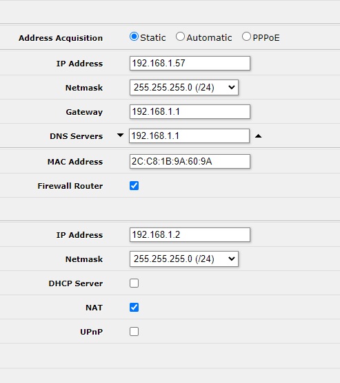

So I tried to tweak a little bit more but still unsuccessful.
On the Quick Set page I tired the config you can see attached.
But it wont work. I think i am doing something very stupid wrong.
Note that the IP 192.168.1.2 is below the DHCP Range of the Fritz!Box Router.
Do I need to untick the Firewall Router tick? I think that might cause a problem since it is just supposed to be an AP?
Best regards :slight_smile:

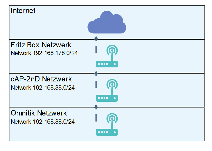

Problem 1: You don’t have 1 Network but 3-Networks
I quickly drew a small overview of you network (See attachment)
Very simply explained,
Top-Down communication isn’t possible
Bottom-UP communication is possible
For exemple :
Wenn your Laptop is connected to your Omnitik-Wlan,
your will be able to communicate with every device on all 3 Network
But if you connect you Laptop to your Fritz.Box-WLAN
you will only be able to communicate with the Fritz.Box Network
Device in the Cap and Omnitik wont be visible.
Problem 2: Both CAP-2nD and Omnitik have the same IP-Range
Both cAP and Omnitik have the same IP-Range and are connected with each other.
So if you decide to keep all 3 Network, you will have to change the IP-Range of the Omnitik
Thanks for the Network sketch!
Maybe i am wrong but when i disable DHCP and assign the Acces Points to a IP of the Fritz!Box i should have one Network or?
The IP Adress Local field in the Quickset seems to be the same one as the IP of the Bridge. So i have to assign a IP adress of the Fritz!Box that is not used by its DHCP or does it has to be the same as the WAN Interface IP (192.168.1.57)?
The DNS Server and Gateway has to be equal to the ones of the Fritz!Box?
I´ll try to do this in the webfig menu and not the quick set.
