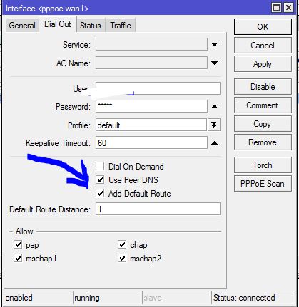

Oops - this was for PPPOE - sorry, needed to have a coffee before posting !!!
I will give that a try when I get home, don’t know how I missed that option…
I’ll update the post either way. Thanks for the idea!
My bad - that was for pppoe :smiley: .
