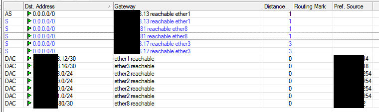

We have the IP → DNS configurated with Google Open DNS and still have the problem. In fact i need connectivity to other things beyond updates but unfortunately dont work.
My route list in attach, any help? The interface ether have connectivity to exterior (with ping tool of winbox selected that port works fine).
Your active default route points to ether1 but you say you don’t have internet connectivity there.
That is not going to work. You need to limit the routes to what actually works.
