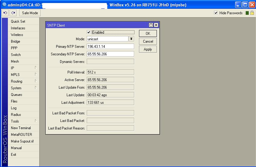

To set clock or time in mikrotik,
Thru winbox, click on system ------SNTP or NTP client, then click on enable and select unicast and put the ip aadrress of the ntp pool server og your choice.
See attached picture
But before, try and go to this link http://www.pool.ntp.org/en/, to select your country or nearest ntp pool server of your choice. Then copy the server 0 (name) or any two servers you see, then paste it there, the ip will appear, as mikrotik will just dsiplay the ip of that site and try to synchronize with it.
Hence, go to system/clock to set ur time.
I hope this helps
