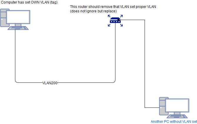

my simple test setup:
Computer has set up own VLAN identifier.
I have one global bridge on my CCR1016 on all ports except eth1 with enabled VLAN filtering
So frames on L2 with setup VLAN is ignored.
I want to change/remove VLAN tag from frame receive / sent to computer which set VLAN
Example in this img:
Thanks for answers
You can only strip the tag of vlan id 200 in a direction of “Another PC”. Just bridge port of “Another PC” with interface vlan 200 and frame shall go in port without tag. The both port will belong to this vlan. But port will be like “access port”.
In Bridge Vlan, set the port for PC as untagged for Vlan 200, then in bridge port, set the port pvid to 200 under vlan tab
