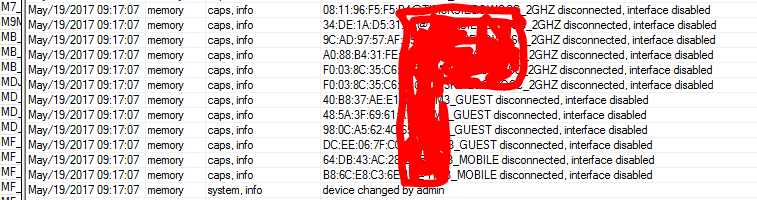

Changeing interface in the CAPSMAN
When the interface name is changed then all inteface is taken down so it means disconnecting all user from particular AP.
Could it be avoided ?

Why they are dropped ? ROS knows that it is only name change. No other paramaters.
If I change Ethenet interface name then I do not see “link down/up” and dropping users from that interface. Why it is neccessary for WiFi ?
