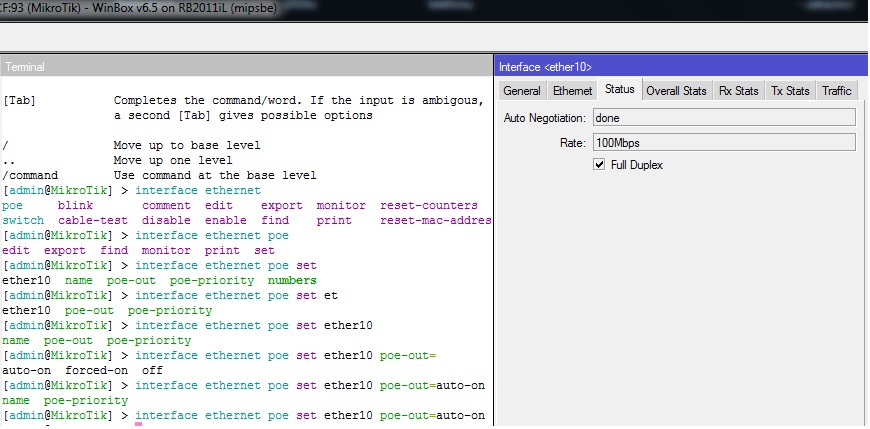

In 6.5 is still missing POE out menu in winbox. In terminal it works on 2011iL
