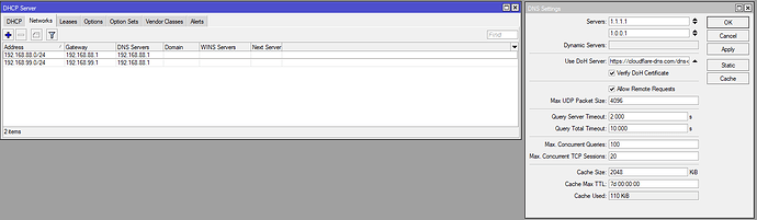

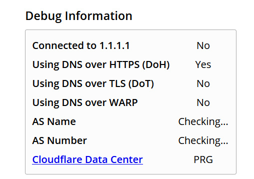

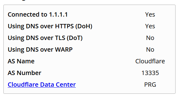

  2. I am connected to cloudflare DNS + DoH and while verifying my settings it 50% of time shows the following:
    however upon refreshing, it shows the OK result

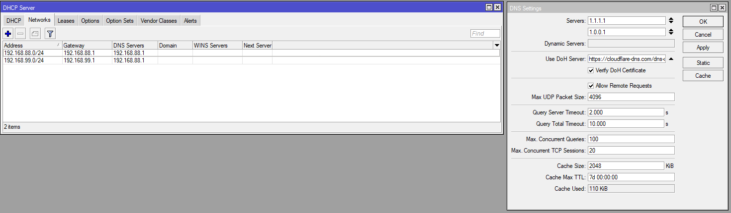

    Is this bad, what can I do to fix it? I have DNS set also in my DHCP server, shall I remove it and keep it only in section where I configure DoH?

Oh, okay sir, didn't know this is bad.
dns must be set on dhcp-server network

this is the current settings, anything else needs to be done?
thank you
about this is ok,
I do not see any security issue
