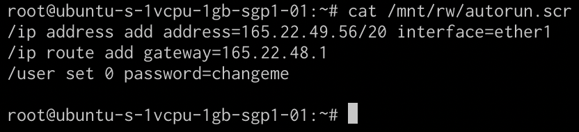

My script, very basic:

Well, the previous image method had an autorun.scr file in the second partition in the /rw/ folder. This worked flawlessly.
The current image method still has /rw/autorun.scr, so I can only assume that because the file exists, that is the file that we’re supposed to be using. I’ve tried naming it autorun.rsc, which doesn’t work either.
