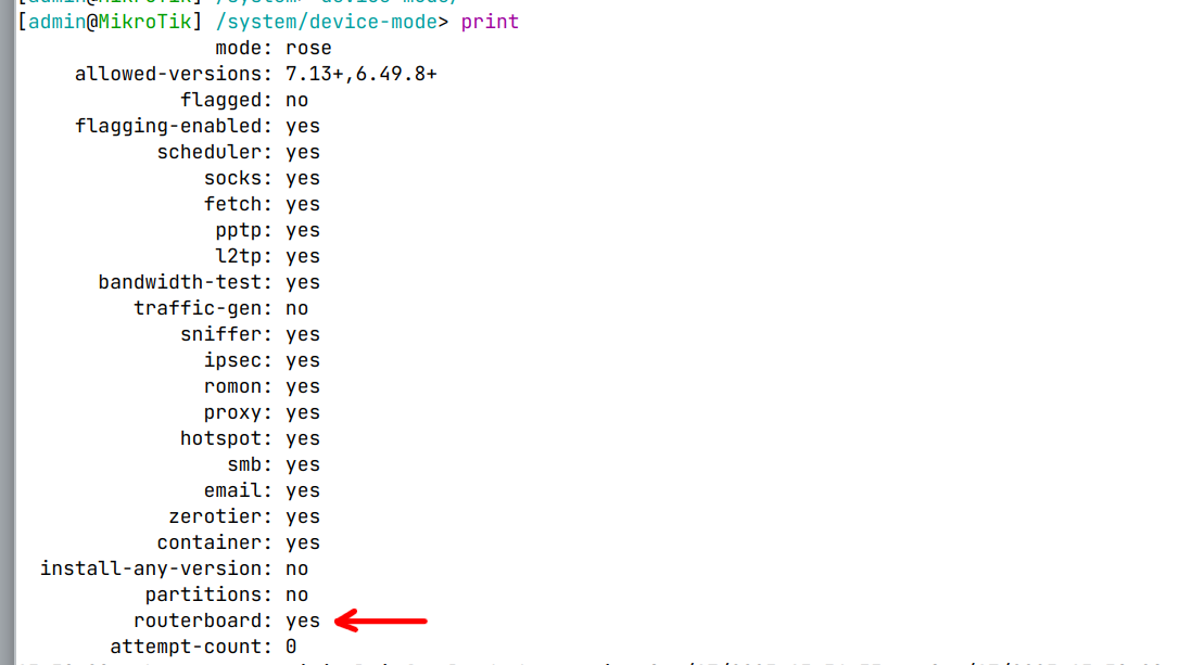

After upgrading the SXTsq 5 ac from RouterOS 6 to 7.19.6 - I noticed the warning message about the wrong CPU frequency.
Tried to set the Frequency to auto - got a message failure: not allowed by device-mode
but the device-mode is set as advanced.
Tried on winbox 3 - same result.
May be this is not a big problem....
So, what does this mean?
Thanks for sharing the info about the rose mode.
I got it worked: I had to manually set:
/system/device-mode> update routerboard=yes
After that I was able to change the frequency
