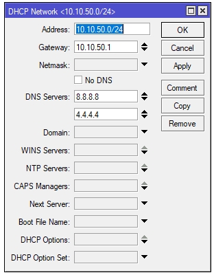

So I entered as DNS server 192.168.177.185 (which is the Pi-hole) in the DHCP Network settings for this virtual WLAN (10.10.50.0/24).
Works fine.
But in the evening the kids should have full access to internet, without re-routing through the Pi-hole.
Therefore DNS servers are set to 8.8.8.8 and 4.4.4.4 in the DHCP Network settings for this virtual WLAN.
The changes are not recognized by the system until MT2 (the WLAN router) is rebooted. ?:expressionless:
