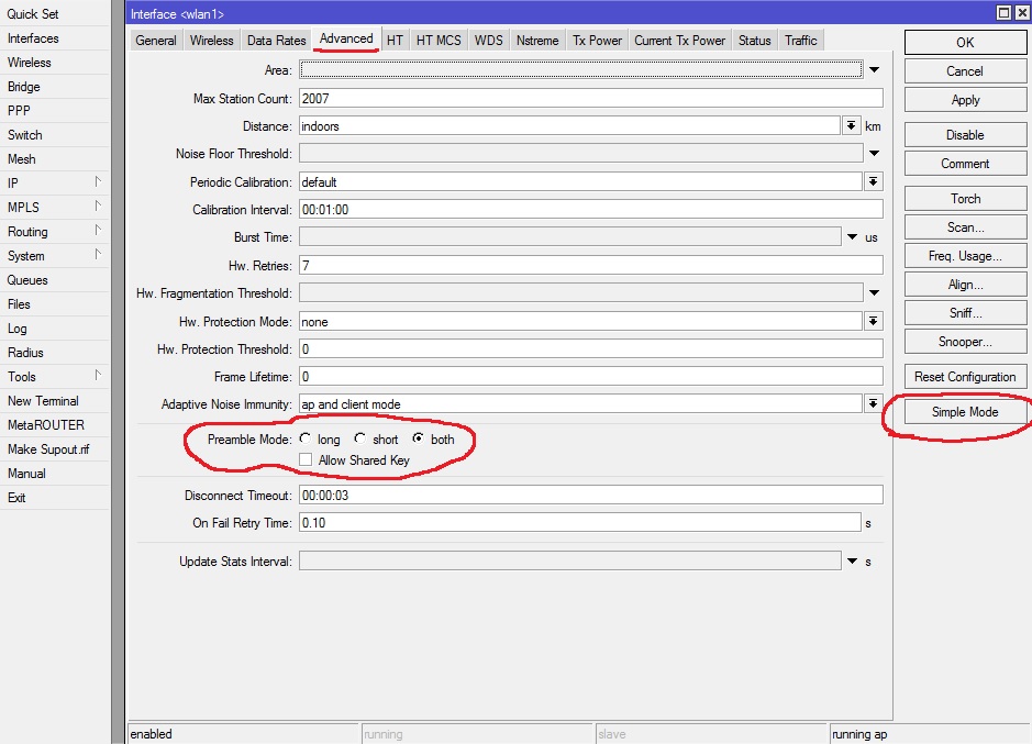

I’m looking to change the preamble-mode on my RB2011UAS-2HnD-IN RouterOS 6.5 using the Winbox.
Wanting to get an iPod touch to connect, saw as article indicating I need to use long or both option for premable-mode, no clue how to do this or even where the option is?
If you are using winbox, you should open wlan interface settings, click “advanced mode” in the right menu, go to the “advanced” tab and choose preamble mode. Both mode is set by default.
