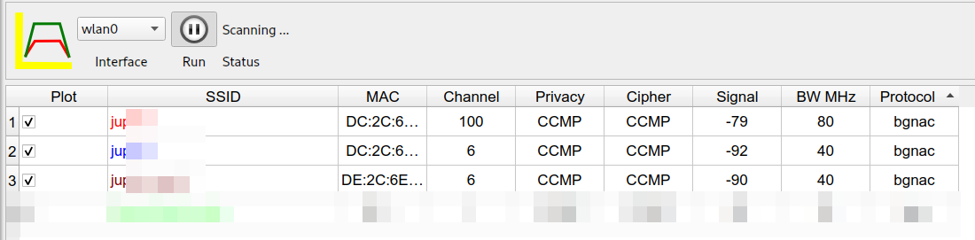

But heres the catch: Before the change to wifi-qcom-ac the channels were 20MHz wide (as per configuration) and did not overlap.
Since the upgrade the channels seem to occupy 40MHz even if I configured them to be 20MHz wide (see config above).
Attached is a screenshot of LinSSID showcasing the problem. I checked before and after the switch to wifi-qcom-ac and this problem only started after upgrading from the old wireless driver.
Any Ideas? Possible Bug in RouterOS? Possible Bug in LinSSID?

Please write to support@mikrotik.com and send us supout.rif file from one of the APs. We will take a look. Is “LinSSID” reporting 5GHz frequencies correctly for you?

Yes, LinSSID reports the correct 5 GHz frequencies.

Just installed LinSSID cause I was curious too.
LinSSID reports 40MHz bandwidth here too. I too have configured 20MHz channel width on AP.
But the android app “analiti” says it is 20MHz.
Who is right? Most likely LinSSID is wrong.
I have different devices and different platforms (MacOS, Android, Linux) and all report 20MHz.
might i suggest Nir Sofer’s “WifiInfoView”?
this will decode the 802.11 beacon, like wireshark would, but with a much simpler setup :
https://www.nirsoft.net/utils/wifi_information_view.html
Your screenshot also shows “b” protocol on channel 100 and “ac” on channel 6. This is obviously incorrect.
:rofl::rofl::rofl:
Even the reported signal is not reflecting the reality.
Ok, so LinSSID doesn’t seem to keep up with wireless technology…
Any suggestion for a good 802.11/wifi analyzer running on Linux?
The only remaining mystery:
Why was LinSSID reporting the correct channel bandwidth utilizing the old wireless driver?
Nevermind, LinSSID seems to be abandoned by it’s developer.
