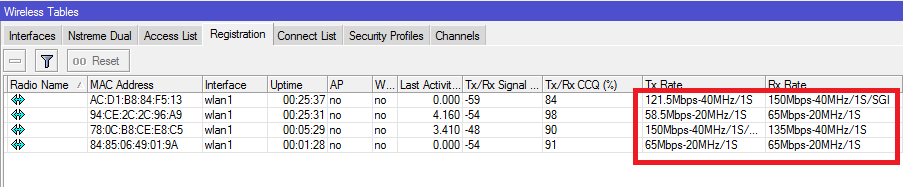

Normis, at the beginning i was scary to implement Ce or eC. Now i did, see the result
