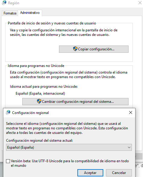

What is your locale for non-Unicode applications (such as Winbox)?
You can check by going to “Control Panel” > “Region” > “Administrative”, under the “Current language for non-Unicode programs”. Also if you click the “Change system locale”, do you have the “use UTF-8…” checkbox checked?
Displaying all characters in Winbox is sort of an impossible feat I think… I thought you effectively have to pick either Chinese or western European, but can’t do both. If you’ve somehow configured Windows to let you type both in Winbox, and have it displayed correctly, then surely, there would be a way to convert UTF-8 to that combination, but I would have to replicate the settings that your Winbox uses to see what’s actually going on.
attached my settings.
But yes i can’t type both chinese and European on winbox.
Oh. Well, if Winbox doesn’t allow you to type in both, then PHP is also working as expected.
