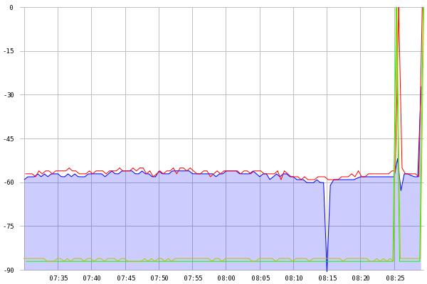

I do poll every 30 seconds, so I changed the datasource on one of the devices signal strength to a function with the following:
oid(“iso.org.dod.internet.private.enterprises.agere.orinoco.orinocoObjects.orinocoIf.orinocoWORPIf.oriWORPIfStatTable.oriWORPIfStatTableEntry.oriWORPIfStatTableAverageLocalSignal.3”,89,29)
If you check the attached file, the blue line is the one with that function, the rest are just set to snmp oid. When it dips right off, that’s when I was setting it, and you can see to the right when I wasn’t able to get a reading. The stats that are still snmp oid defaulted to 0, where as this new function did a kinda up and down thing, which is good, as that’ll average itself out perfectly. I haven’t tested an extended outage, although in theory I shouldn’t have one.
Cheers for your input.

That little up/down on the right is a timing error and a strange one, They are usually down then up… Where a read is not made in time to add it to the correct point in the graph. EDIT oh right you are reading a negative value… so the up down is the same as reading a positive value just reversed. And yes it is clear that it might have worked compared to the other probes…
That cache value and negative cache value is not factory so remember that you are out of spec with some of your probes :slight_smile:
