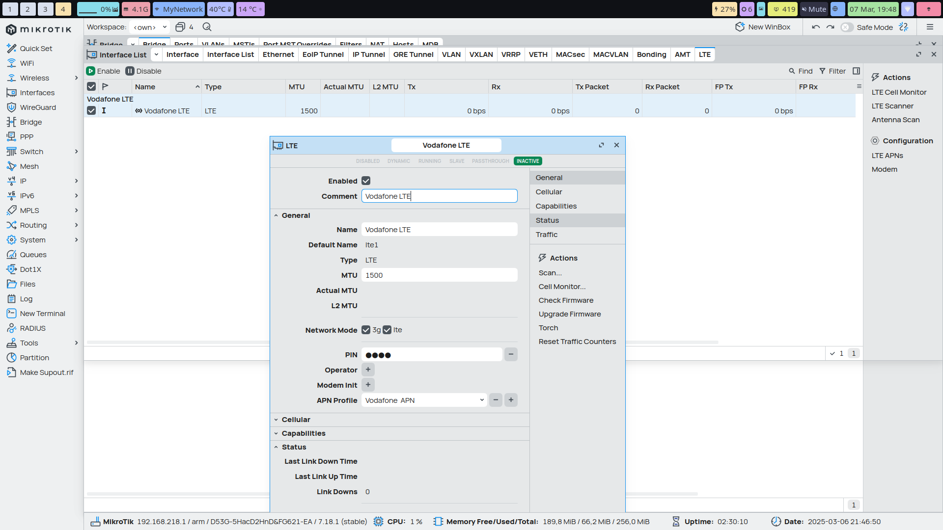

i recently bought a “Chataeu LTE 6”. Setup was straight forward and Internet over LTE is working fine.
BUT,the modem sometimes is missing after a reboot. Means, i need to reboot up to three times to bring the LTE connection active → RUNNING
Here is screenshot with a working LTE Connection. There is an information about the modem below the APN Profile and everything is fine.
Then after a reboot out of WinBox “System” → “Reboot” the LTE Interface is “INACTIVE”
I did NOT changed anything in the Config, just reboot.
I’m on “Router OS 7.18.1 - Stable” with the latest modem firmware.
Is there any more information that i could/need to provide ?
