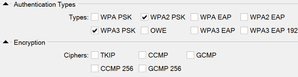

You are correct - indeed, in the security options I was setting CCMP 256 and GCMP 256 which probably prevented the clients from connecting. When I cleared all the checkboxes and left only WPA2 and WPA3, AX and AC clients connected successfully. I guess that if I set AX on the 2.4 band, N will also work.
Thank you very much for this hint. Just one more question - how can I disable TKIP as encryption method and the legacy standards - a/b/g and leave only n/ac/ax? Currently I haven’t checked any of the cyphers and I guess that all of them are acceptable.
You may want to look at output of command /interface/wifi/print and /interface/wifi/security/print (run them in terminal window … you can start one from WinBox or connect to device using ssh) … and look for “encryption” property in both outputs. Only then you’ll see what is actually configured on device. Default (if property is unset) is “ccmp” only … which is basically good ole AES in WPA2. So if you don’t enable it explicitly, TKIP won’t be available.
According to my experience it’s mostly safe to enable “ccmp,ccmp-256” while any of gcmp tends to freak out many not-so-modern devices.
