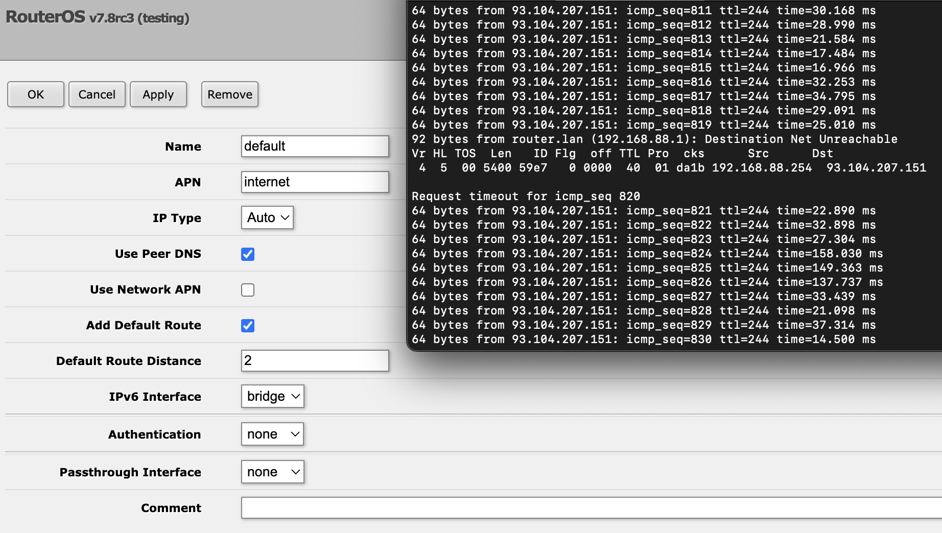

The issue seems to have been finally resolved by deselecting the option “Use Network APN” as the Mikrotik support was hinting at.
In this case, only one or two packages are lost during the ISP disconnection which is more than acceptable:
@littleendian did you meanwhile upgrade ROS to 7.8?
It seems that on ROS 7.8 is better lte recconection handling, my netwatch down event is not entering in condition :if (![/interface/get lte1 disabled]) after upgrade, probably in recconection period when lte link is down lte interface is disabled. Up event is triggering ok afterwards, from where I call script to refresh IP on dyndns service.
Edit: Silly me… from your screenshot it is ROS 7.8 :slight_smile: That probably explains better reconnection behavior, on my lte apn setup “Use Network APN” was always disabled but still there was problem until 7.8.
Sorry for the late reply. Yes, I updated and at least so far, the reconnect seems to be a lot faster (being on 7.9rc3 meanwhile).
