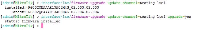

My problem solved after upgrade to the latest beta modem firmware RG502QEAAAR13A03M4G_02.004.02.004
