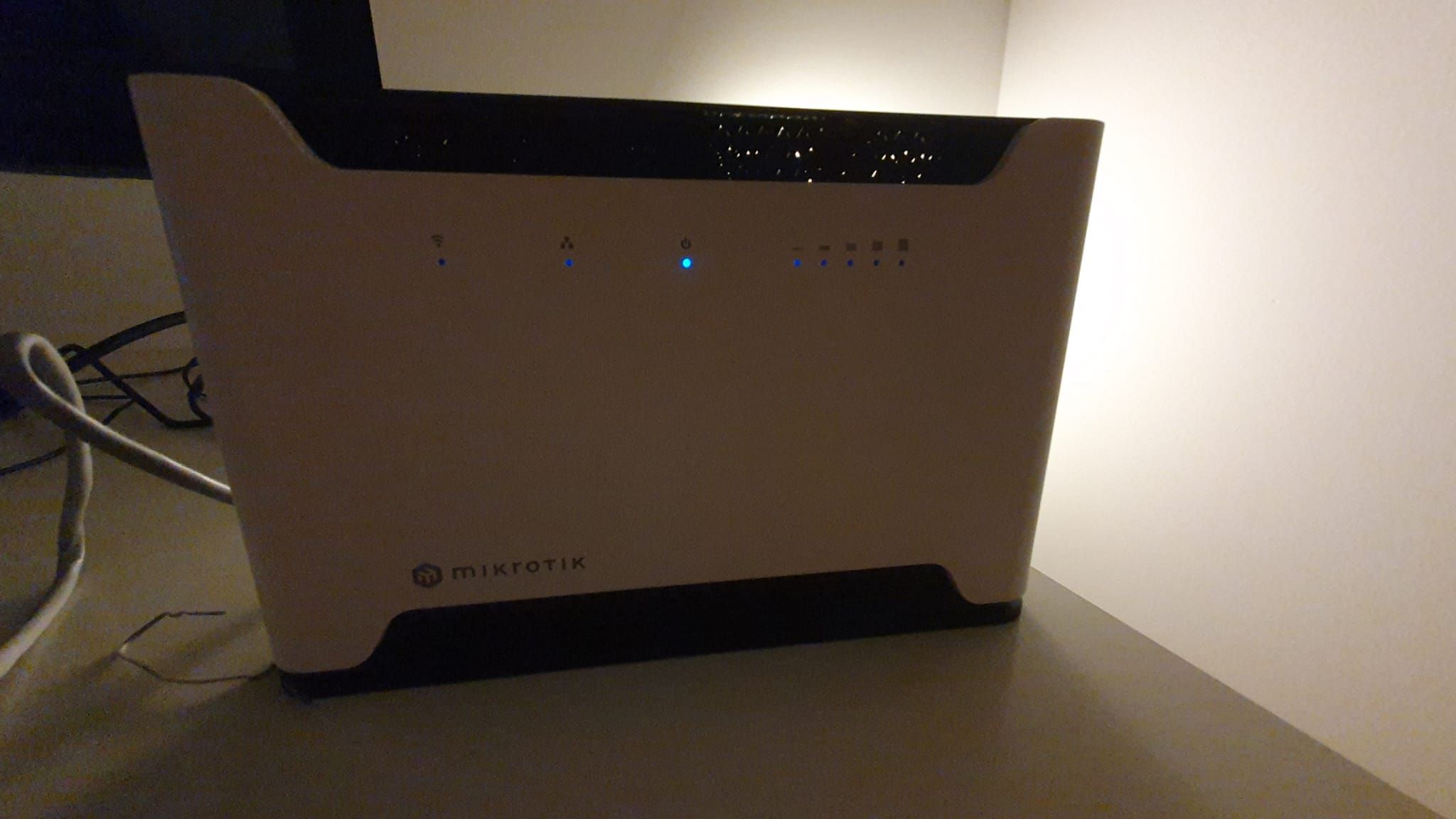

I have router Chateau 5G model: D53G-5HacD2HnD RouterOS 7.15.2 and about twice a month this router stops working.If I will check LEDs then only blue LED is there.
Router dont have configured IP.Its not reachable via winbox (via IP and also via MAC) and clients cant take any IP from DHCP.
Only a reset will help, hold reset button about 9 sec.Then router will have default config.
How can I find out what happened or what is the state of the router?
Thank you very much for any advice.
