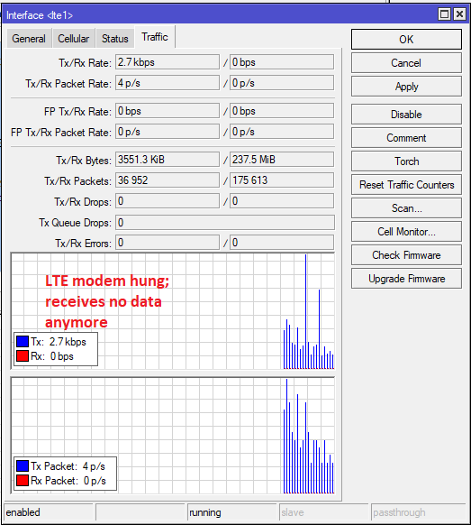

Sometimes but not always do I get the “lte,error lte1 mbim: modem’s control interface have reset” log message when it stops working. It seems once in this hung state the LTE connection is still established and sends some LTE data but receives no LTE data anymore. Disabling/enabling the LTE interface resolves the issue.

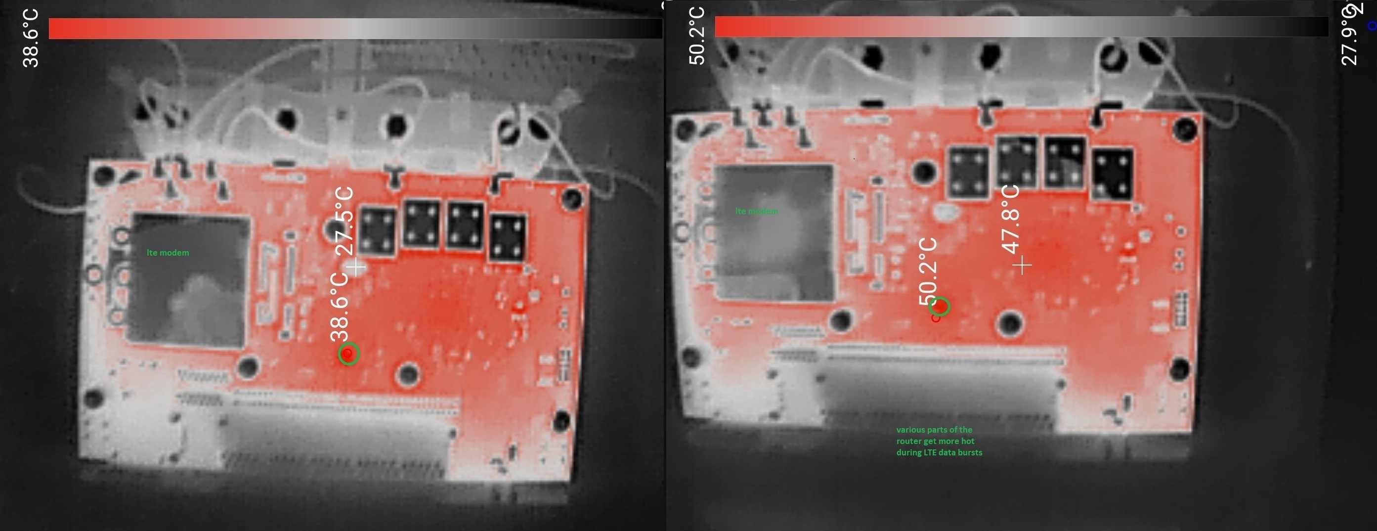

For me too it seems to happen mainly during data burst - for instance when performing a speed test and similar. The LTE modem does warm up in such cases but the temperature still seem to be in normal ranges. Other parts of the router warm up too, even more so I would say. I may try to install some heatsinks next and see how it goes.
Actually I downgraded to RouterOS 7.7, and the lte interface doesn’t reset anymore (which is weird), but it links down/up very often during speed test

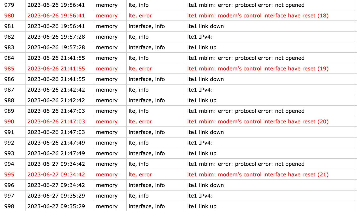

Same here with 7.10 firmware, device - Mikrotik 5G LMT
lte1 mbim: error: protocol error: not opened
lte1 mbim: modem's control interface have reset (17)

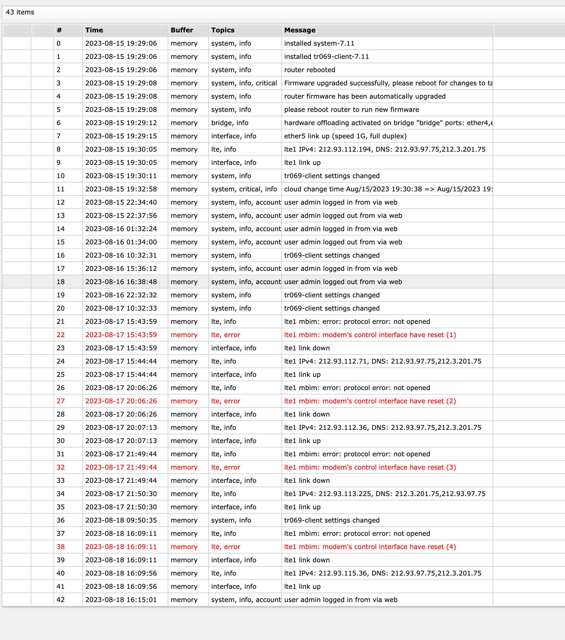

new firmware - 7.11 - still the same :frowning:
8 reboots in an ±1 hour :frowning:

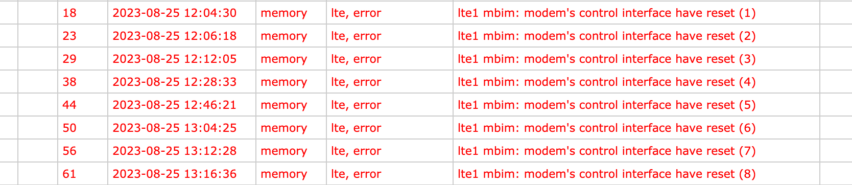

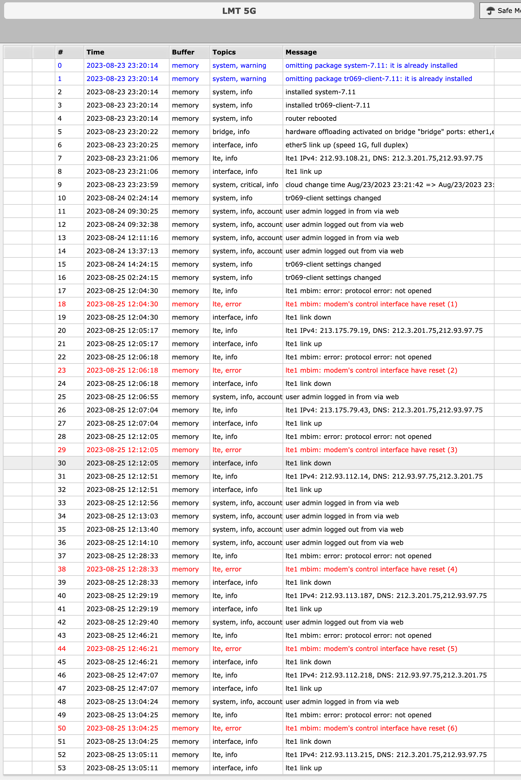

Installing heat-sinks on the CPU and modem didn’t help. It still happens with the latest routeros 7.11.2 and I get it on a daily basis. Disabling/enabling the LTE interface does solve it once it happens for me.

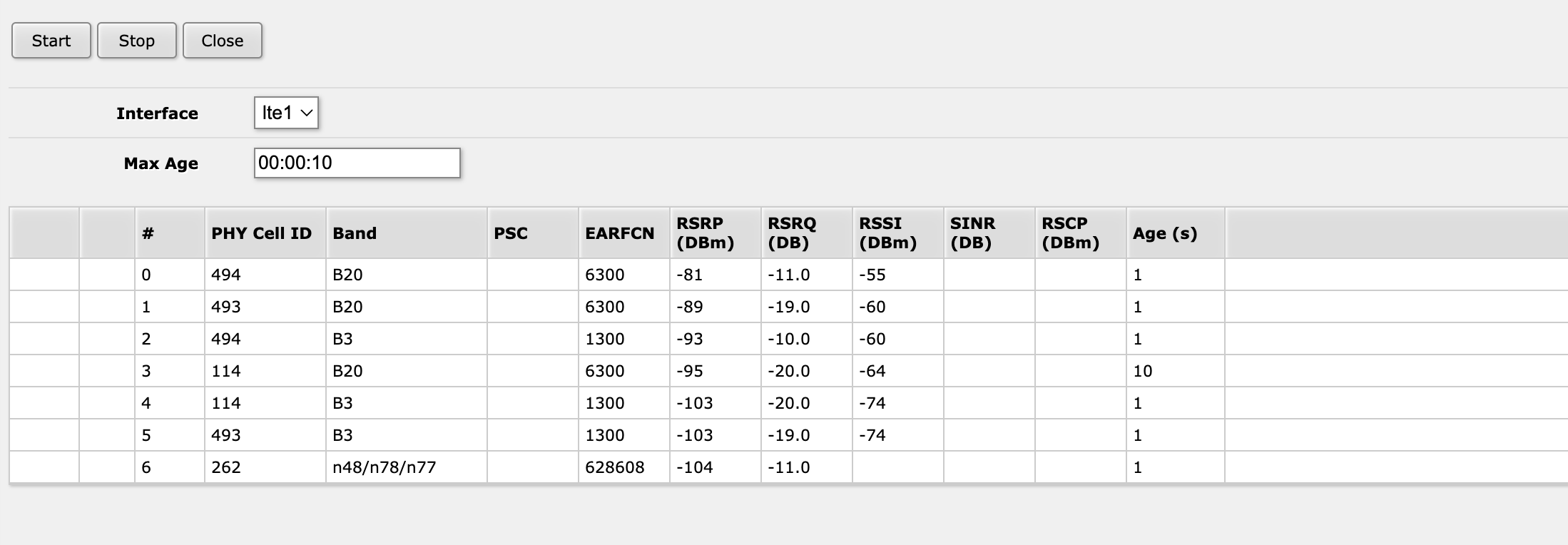

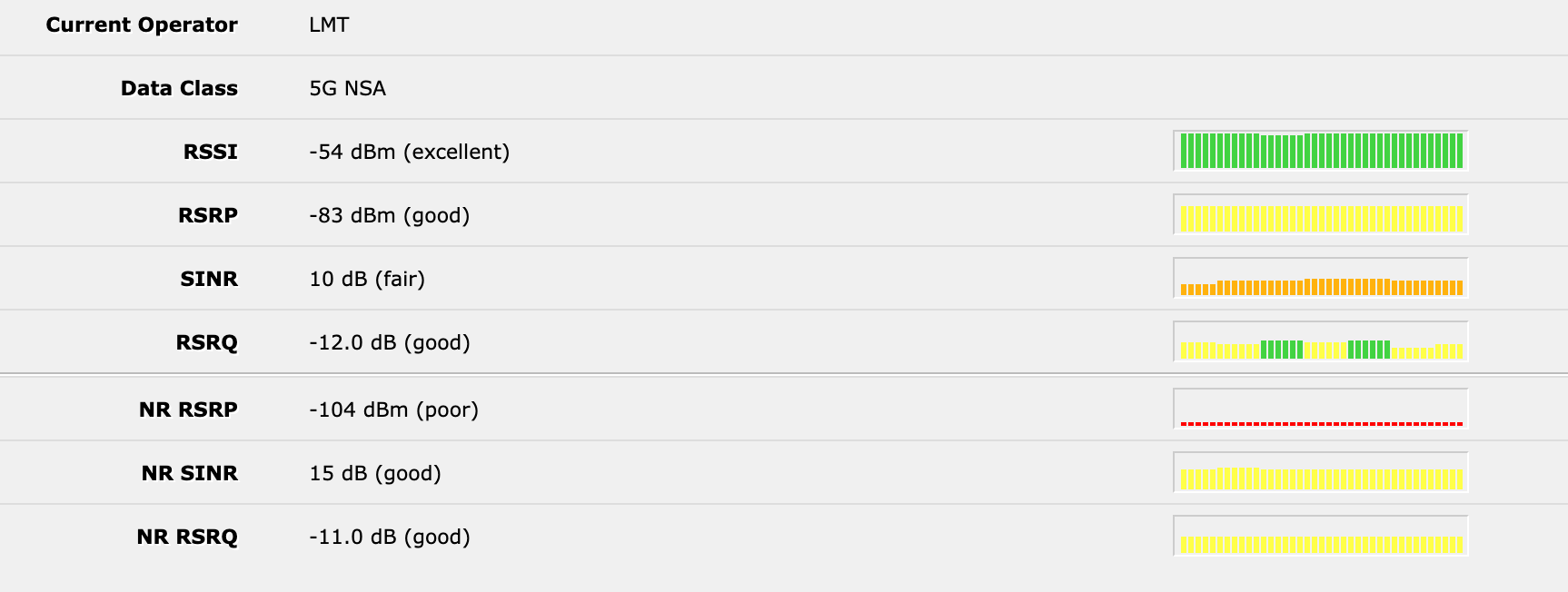

For me, it looks like it is connected with 4G\5G coverage - if the router is switching between 4G\5G, 5G is crashing more. I placed the router in a different place, where 5G is better - and lte1 was reset less often.
What your signal look like? When you move it do the bands or other things in the signal data change?
/interface lte [find] monitor once
You might want to add more logging…
/system/logging/add topics=lte,!packet,!raw
If the RouterBOOT firmware is NOT matching 7.11.2, you might want to update that too…
/system routerboard upgrade
If those don’t work or debug logs don’t have any clues, you might want to make supout.rif, and file a report a Mikrotik.
