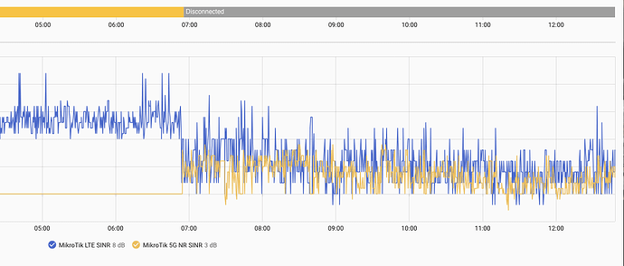

thanks for your feedback. I neither wish to operate at cell level :wink:
however, still do not understand why signal weakens when 5G is on vs. off, see ie. my charting (left was LTE-only)
Is there any explanation for this?
It could be that network forces modem to connect to different band/cell when modem admits it can do 5G NSA. And that different band/cell could either be a more far cell ... or it can be higher frequency one. In both cases pathloss (signal strength loss while traveling through air) would be higher. The thing is that not all LTE cells can "piggyback" 5G NSA cells. It might be that in your particular spot signal strength of LTE-only cell is stronger than of LTE+5G cell.
So if you're willing to experiment, set modem to LTE-only, record all cells in use (both when modem is "idle" and while actively transferring data), if possible with corresponding signal strengths and band indications ... then set modem to 3G/LTE/5G and record the same data. I guess comparing both data sets might show something.
