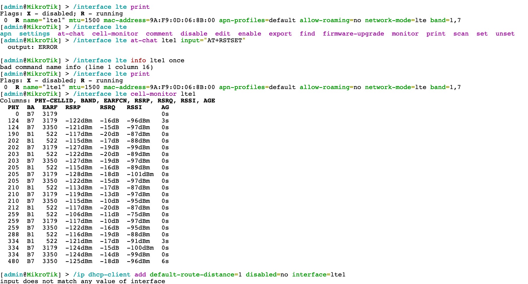

My new Chateau won’t get an IP from LTE (the card connects fine, I can see the bands, I can even send SMS to it no problem and see the SMS in Winbox).
So it seems like it doesn’t have a DHCP client, but I also tried to put a DHCP client on the lte1 interface per the instructions in the manual but it says it doesn’t know that interface. However I can see the lte1 interface in all other areas.
Attaching a screenshot so you see what I mean.

resolved, this is what support sent:
It seems like you receive only an IPv6 address on the lte1 interface.
Check with your mobile operator what APN you should be using. Also please add use-network-apn=no to the APN profile, as by default MBIM modems use the networks provided APN. With some SIM cards it receives an unexpected APN.
CLI commands to accomplish this (replace “internet” with your APN):
/interface lte apn add apn=internet use-network-apn=no (Optional : to set to receive ipv4 only add this as well: ip-type=ipv4)
/interface lte set lte1 apn-profiles=internet
I had to use the ipv4 part too.
