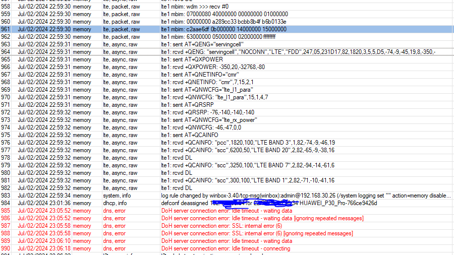

Maybe someone can help to resolve situation with bad working LTE?
Signal strength always good, but speed are low and lose internet connection too often, time out connection to DoH server, ping lost packets, etc
operator BITE, Latvia, <1 km from tower
tried to lock to band 20, to 7, same situation… maybe need to enable mimo 4x4 but don`t know how to do it

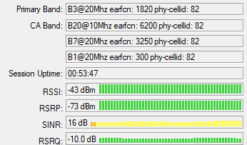

modem firmware is EG18EAPAR01A13M4G_01.002.01.002

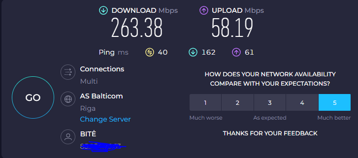

Problem resolved by installing 7.16beta3, then 7.16beta4. No more disconnects for already >24 hours and speed always >50 MBit/s, at night 190 MBit/s :slight_smile:
Very interesting that. Which ROS was it before you upgraded?
before it was on 7.15.2
no any disconnect for 30 hours already,
speed test checked at night time:
