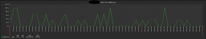

I’ve recently got a Chateau LTE6 for testing before sending it out to site and I’m experiencing wireguard issues.
So most of out devices are being monitored through zabbix and part of that is pinging the host.
DDNS is setup so that the Tik is being pinged regularly on it’s public IP, great not issues there.
Then I also got a Wireguard tunnel with a local IP and that Tunnel doesn’t show me it’s dropping or anything, but I loose random packets
while the public IP is steady
I'm on 7.20.4 stable now, tried previous version 7.19.x
I left all settings default and only added the tunnel, same issue.
What would cause this? Any ideas or you reckon I have to contact mikrotik support?
Appreciate any ideas

First thing which comes to mind:
config should show you have a keep-alive setting on the side of that Chateau so it can keep the tunnel "alive".
It's also not really recommended to base your "down" statement on 1 failed ping.
See if there are multiple failures within 10/30/60 seconds or so. If so, then it's really down.
If not, there might have been a "false" down.
Don't know how to do that with zabbix...

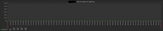

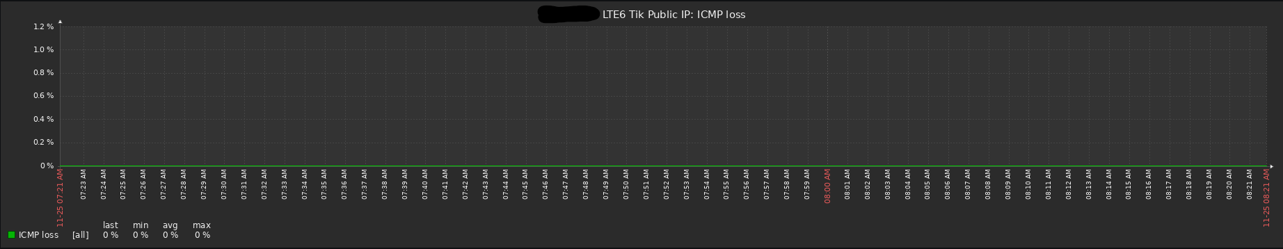

thanks for the insight, my main concern is the continuous dropping of random packets. Other routers we have which are connected to Teltonika RUT955 for example don’t have any drops, only the new chateau lte6 keeps dropping random packets. Something feels off, I don’t know if it’s hardware or software related.
I’ve even taken the LTE6 home, to check if it’s not the local telecom tower doing something. Same outcome, random drops of packets, which might not be a massive issue, but I don’t like it.
EDIT:
Also I agree it’s not really down, but I don’t like the permanent loss, I would say it’s unstable.
If you check the first image I added, that’s not ping directly that’s icmp loss.
