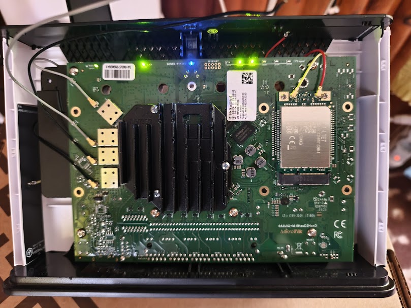

is there a way to connect external 4G/LTE antenna using pigtail SMA?
Whitch antenna connections to use?
Thanks for advise.

Check if you can find your model or a similar one in confused bird forum:
https://confusedbird.com/thread-119.html
as there may be additional notes/info, but the two antenna connectors for LTE are those with yellow and red wires on top right of your image, connected to the "bolted on" modem, which is (should be) a R11e-LTE7:
https://mikrotik.com/product/r11e_lte7
Connectors are 2 uUFL.

What puzzles me is that the router uses the original antennas only for the Wi-Fi connection—meaning only the black and gray wires on the left go to the antennas.
I've ordered the pigtail (https://mikrotik.com/product/acsmaufl) and am waiting for it to arrive. I'll get back to you with an update as soon as I test it.

What Is puzzling?
The device has internal LTE antennas and external wifi ones.
If you follow the yellow and red cables, likely on the other end there are two clover-like PCB antennas similar to:
https://confusedbird.com/thread-119-post-3083.html#pid3083
https://confusedbird.com/attachment.php?aid=1195
