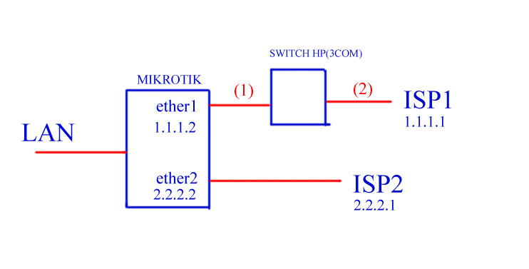

Hi! I try to use dual wan failover on RB951G-2HnD. Two ISP, static public IP. Evething ok.
Example is http://wiki.mikrotik.com/wiki/Advanced_Routing_Failover_without_Scripting.
When I unplug cable from mikrotik (1 on picture), route become unactive, failover works. I even thing that it is not failover, but just one of the 0.0.0.0/0 routes changes to down :slight_smile: manually.
But when I unplug cable 2 - failover does not works.
While cable 2 unpluged I try to ping 208.67.222.222 (which must be pinged via ISP1 - it is setup by /ip route add dst-address=Host1A gateway=1.1.1.1 scope=10):

So, timeout - answer to ping via ISP1 (1.1.1.1). This forces mikrotik to think, that this route via 1.1.1.1 is down.
Mikrotik try to ping 208.67.222.222 via other active route (2.2.2.1), but route to host 208.67.222.222 is only via 1.1.1.1. And cheme should works, as for me.
Why in this situation route via 1.1.1.1 is not marked as unreacheble?

If the configuration is as you have posted, then it is wrong. The right one should be as follows
add dst-address=8.8.8.8 gateway=1.1.1.1 scope=10 target-scope=10
add dst-address=0.0.0.0/0 gateway=8.8.8.8 distance=1 check-gateway=ping
add dst-address=0.0.0.0/0 gateway=2.2.2.1 distance=5
This way you create a recursive route which is checked by ping, and it will ping a live host on the internet (like 8.8.8.8 ). So when ping fails two times, it will switch to the second route which does have a greater distance. Once the host ( 8.8.8.8 ) is back alive, it will switch once more on the primary route.
This is how fail over works, unless you want something else.

Thank you very much for answers. Idea is clear, everything works.
