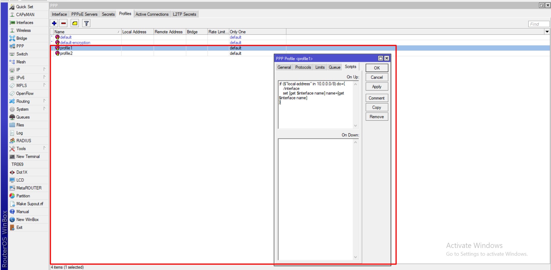

Try this, paste on on-up script on ppp profile used by pppoe-out1 and pppoe-out2:
:if ($"local-address" in 10.0.0.0/8) do={
    :delay 10s
    /interface
    set [get $interface name] name=[get $interface name]
EDIT: added delay for prevent excessive CPU and log usage
Let me know if this work for you.

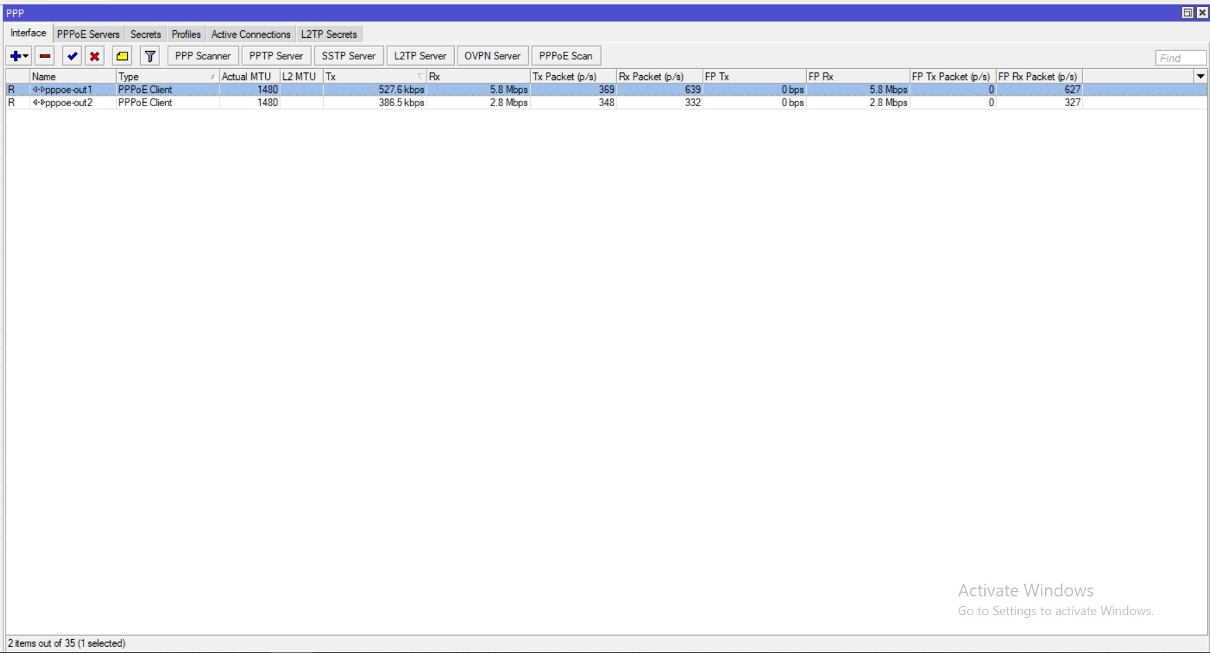

I did paste it this way as shown below:
I’ve created two profiles (profile 1 & profile2)
but I’m not sure which profiles are used by pppoe1 and pppoe2. There must be a way to link the pppoe to the profile number, isn’t it?
do not create other profiles, use default or default-encryption, what is used by pppoe-out

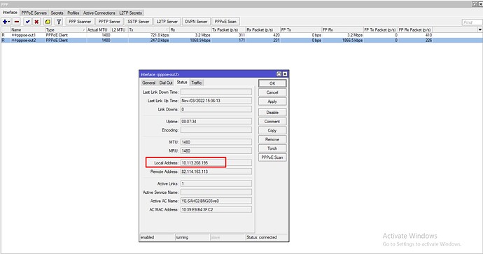

Ok, I did delete the new profiles and past the script into default and default-encryption but how to test the script. what should it do? Will it find the IP address started with 10.x.x.x and then disconnect the connection and re-connect it again?
Currently, pppoe-out2 has this IP 10.x.x.x as shown in the attachment but nothing changed yet after pasting the script to On Up into the two mentioned profiles above.

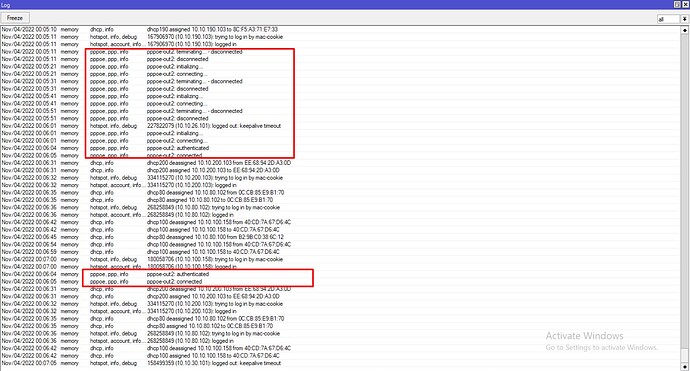

you see the effect on next “on-up” when pppoe disconnect and reconnect

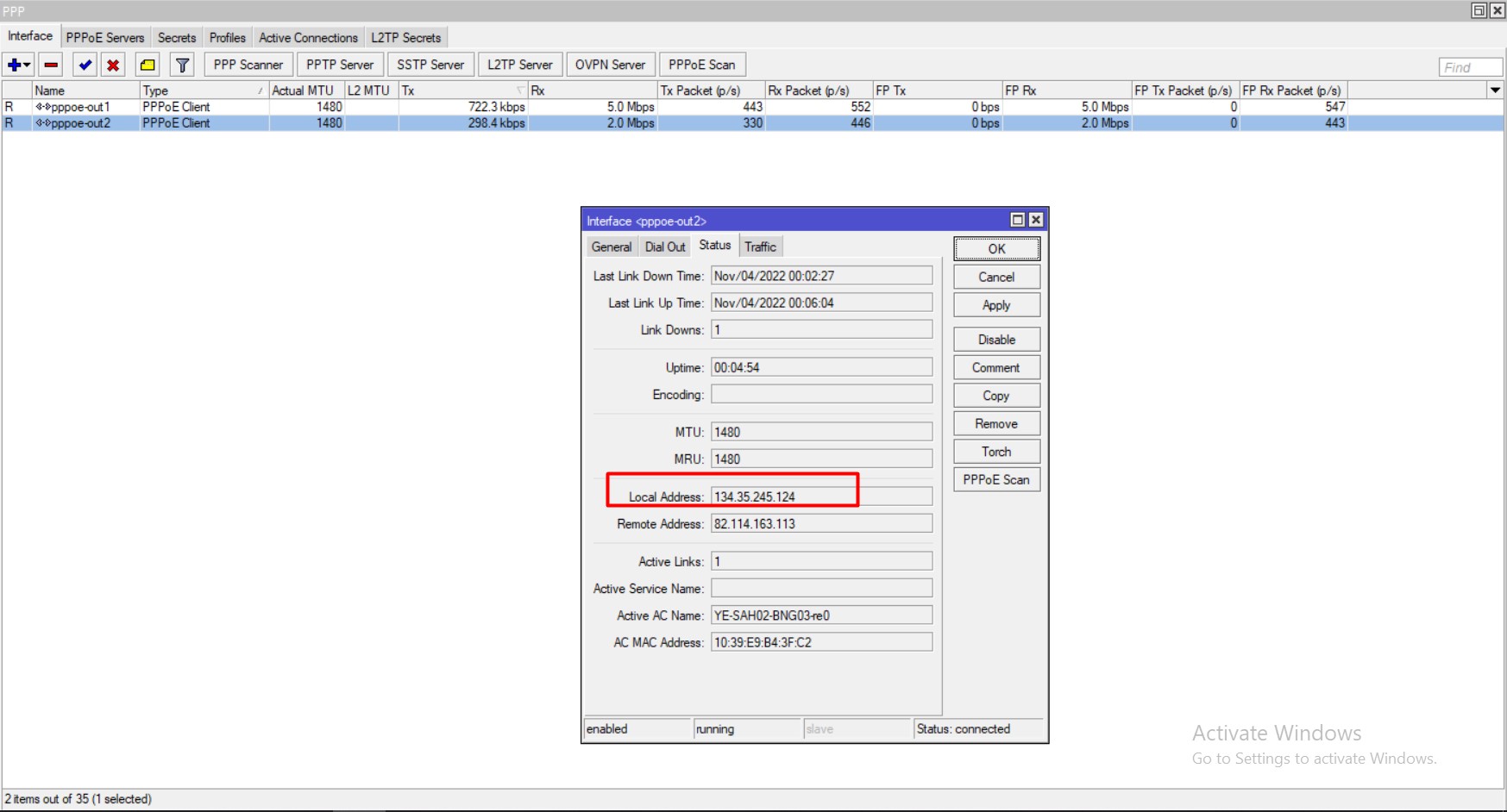

Yes, I did test this by disconnecting the pppoe-out2 and I’ve seen in the log that is connected twice. Does it get the same 10.x.x.x IP in the 1st attempt and then tried to reconnect again?!
BTW, in the 2nd attempt, I got a new Ip 134.x.x.x which is good.

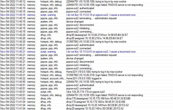

it would be pretty if we log info for what happened during the trials of the re-connection. what do you think :slight_smile:
:local pppIP $"local-address"
:local iname [/interface get $interface name]
:if ($pppIP in 10.0.0.0/8) do={
    :log warning "I do not like $pppIP provided by the PPP Server to $iname, I am about to provoke a Reconnect in 10 seconds."
    :delay 10s ; # this prevents excessive CPU usage
    /interface
    set $iname name=$iname
} else={
    :log info "I like $pppIP provided by the PPP Server to $iname"
EDIT: Added delay for not have excessive logging and CPU use…
Work?
YES YES, I checked today and it is working pretty fine.
