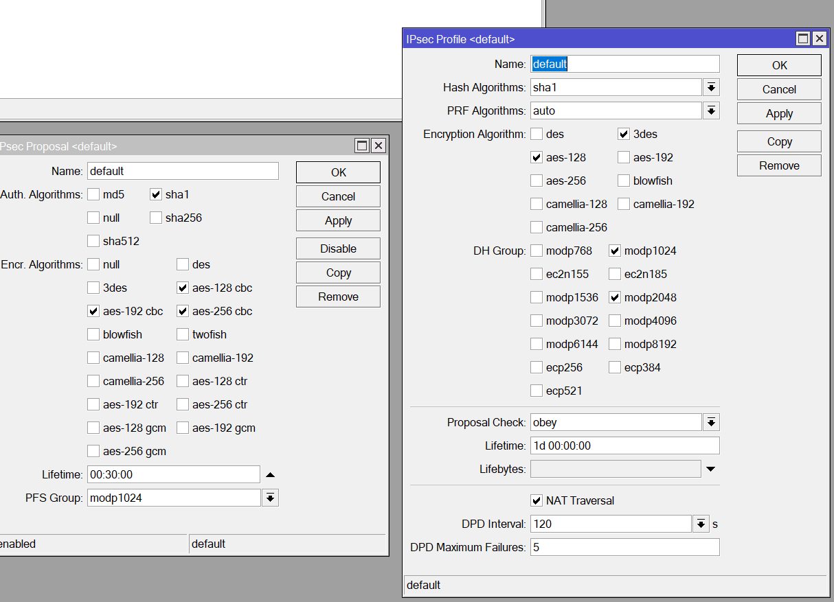

Another option is to disable PFS on the hAp side but this does not help. I changed the IPsec proposal PFS Group from default modp1024 to none and get another error:
“notification message 14:NO-PROPOSAL-CHOSEN, doi=1 proto_id=3 spi=0c6f7361D”
I also tried all other PFS Groups with no success.

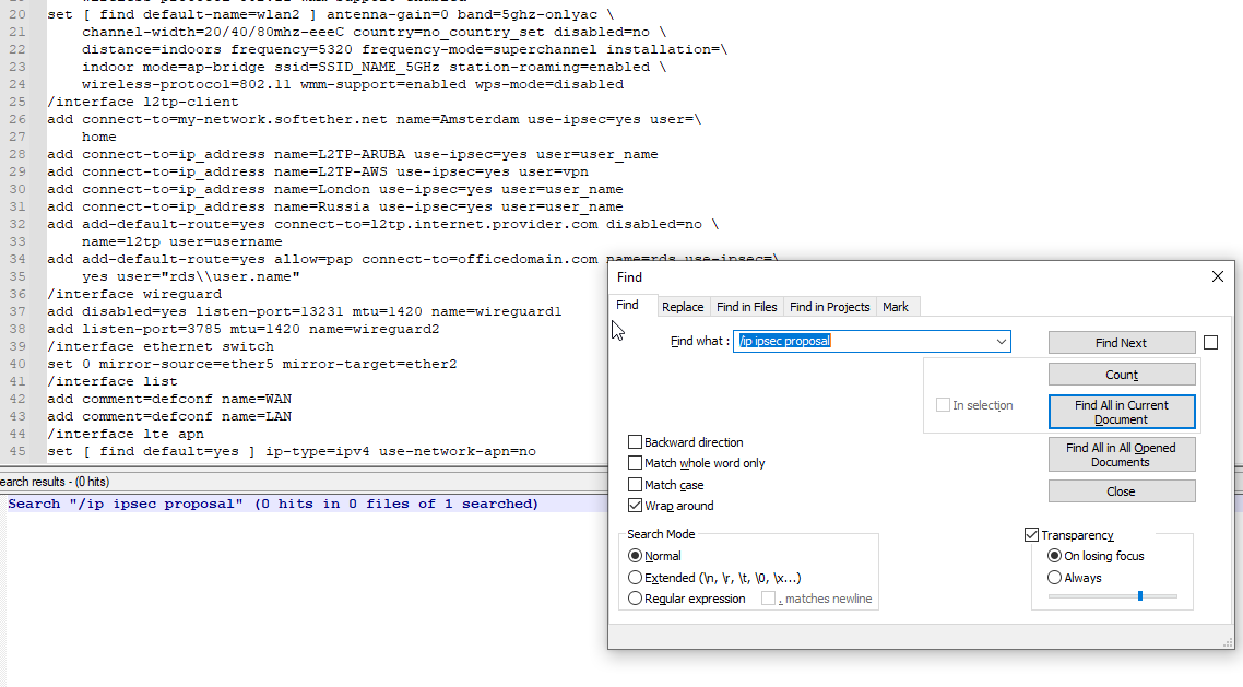

Your export is missing the IPsec P1, P2 section.

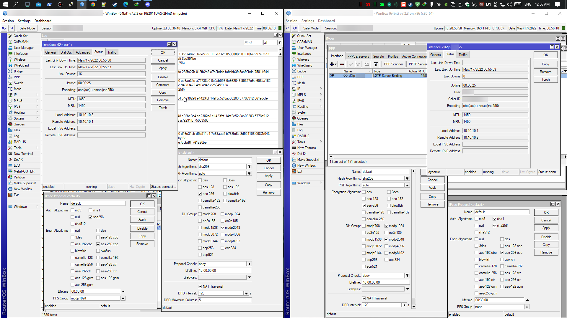

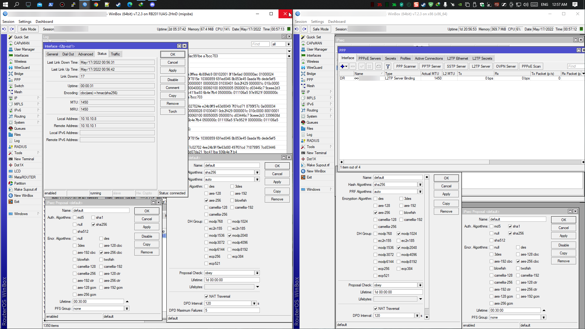

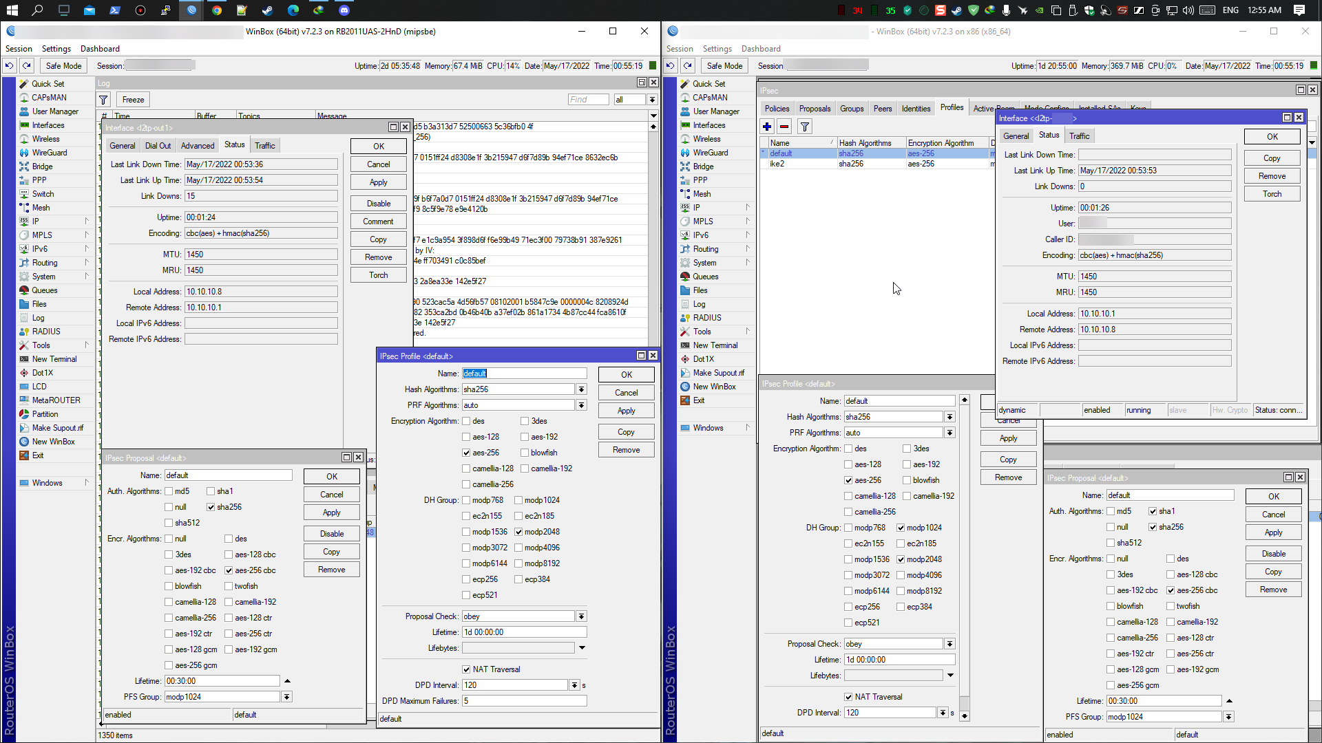

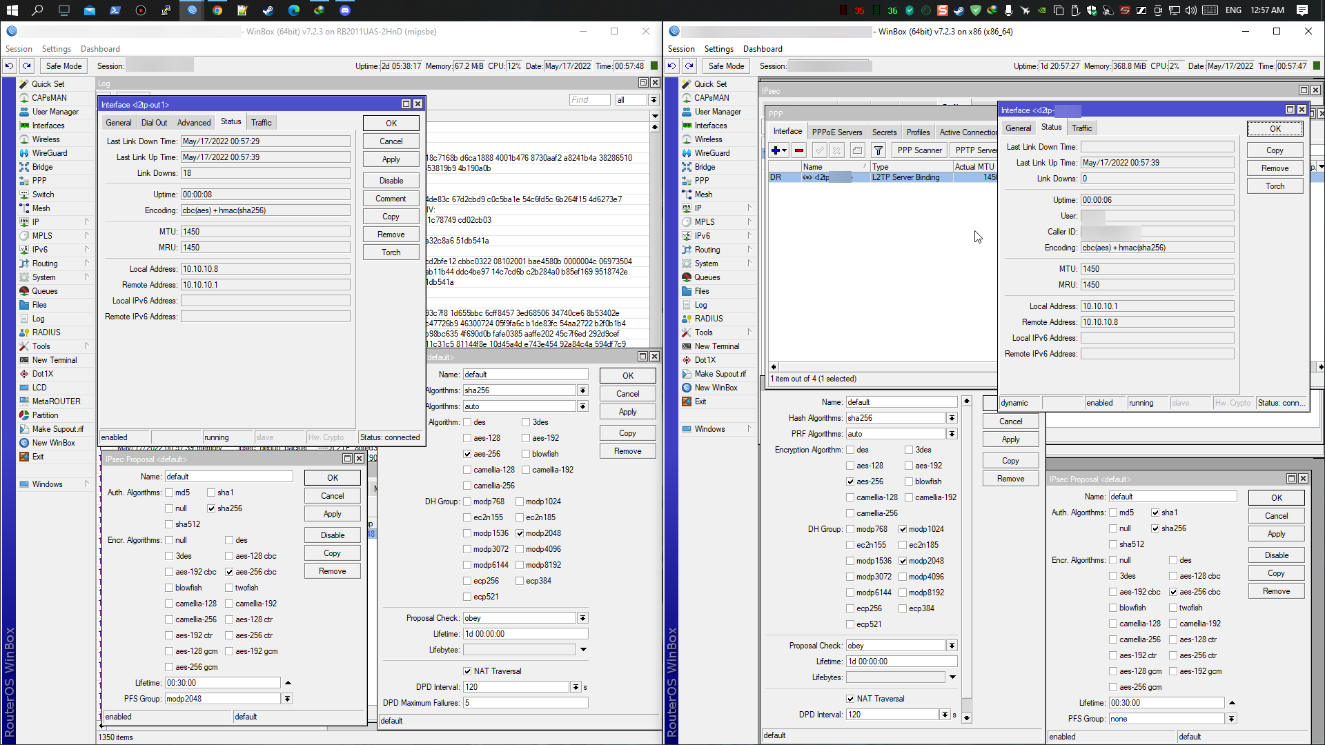

You are right, config is lack of IPsec section. Probably because it is the default. Just in case I attached a screenshot of these settings.

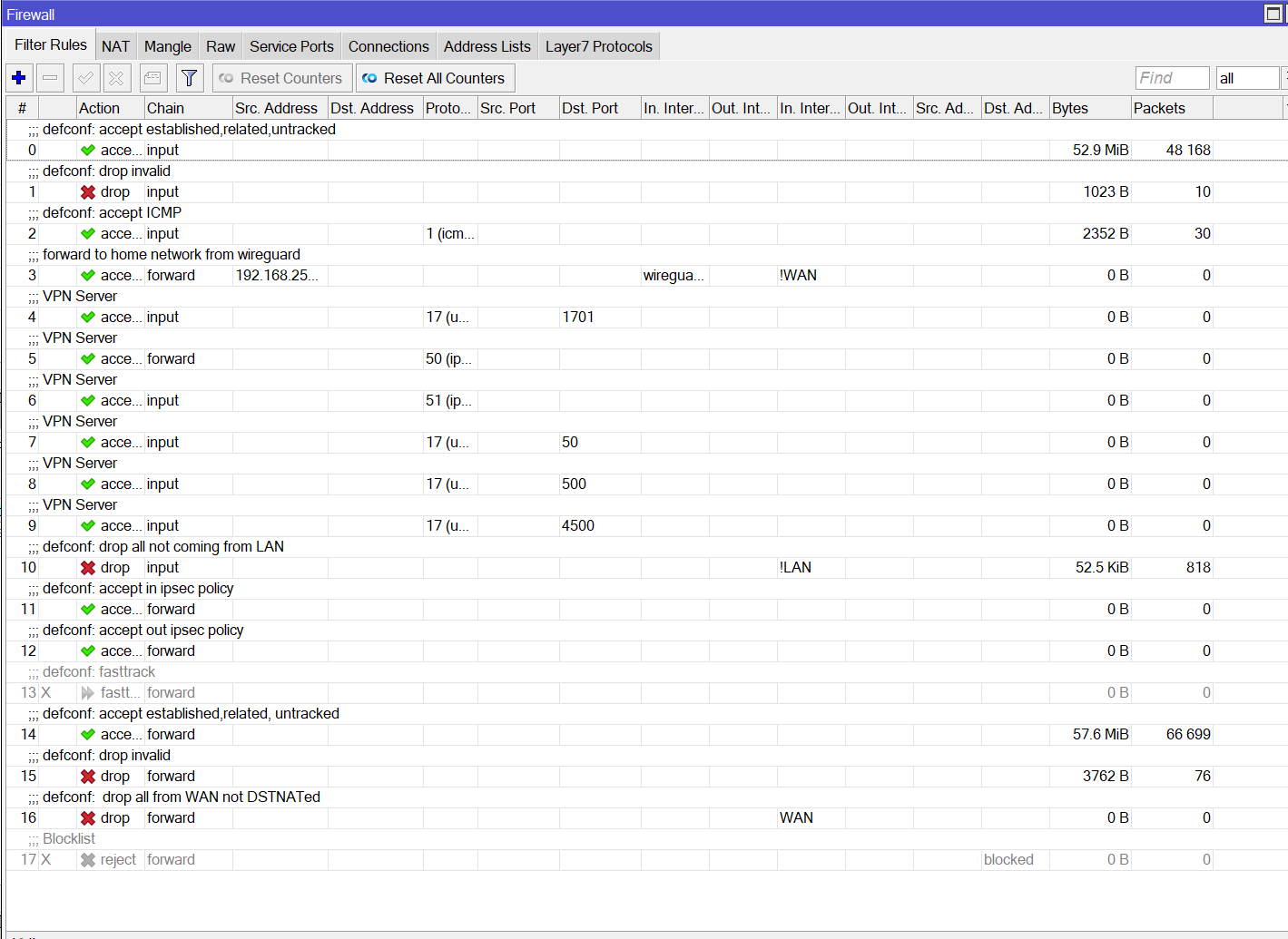

@GreatBeaver
add action=fasttrack-connection chain=forward comment=“defconf: fasttrack” connection-state=established,related > connection-mark=no-mark

fast-track
But you have two fast-track rules in your firewall one of them is disabled and the other one is enabled, when you mark your connection with mangle then you should exclude them with the “no-mark” in the connection mark of the fast-track or accept the marked connection before the fast-track firewall rule.

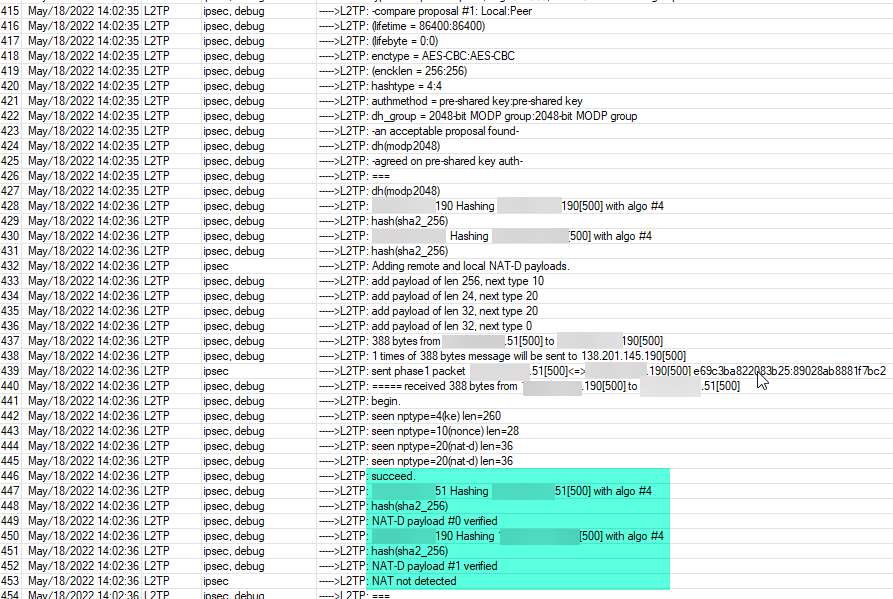

I connected hAP to another L2TP server on AWS with success and compared logs.
Both logs have the “NAT-D payload doesn’t match” error but one that works has just two rounds of hashing instead of 4 on not working connection.
Also, they detect NAT differently:
Working connection: ipsec IPSEC: NAT detected: ME PEER
Not working connection: ipsec IPSEC: NAT detected: ME
I was unable to find what differences between these two NAT modes.
Could you direct me where to look? And what is the difference between these modes?
aws.txt (755 Bytes)
office.txt (1.17 KB)
