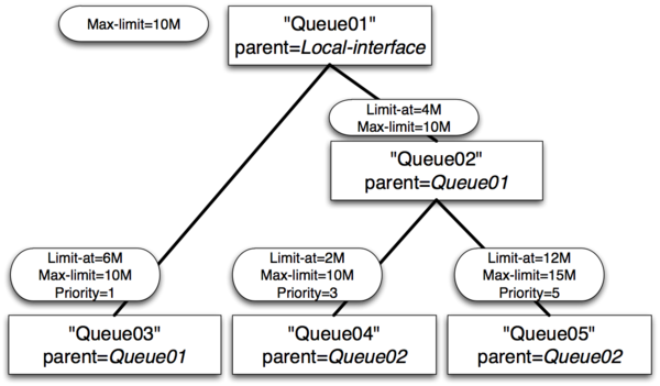

I can’t understand one example I saw on some sites about QoS, here it is (https://wiki.mikrotik.com/wiki/Manual:HTB#Example_4_:_Leaf_queue_limit-at):
The result might be:
  • Queue03 will receive ~3Mbps
  • Queue04 will receive ~1Mbps
  • Queue05 will receive ~6Mbps
Clarification: Only by satisfying all limit-ats HTB was forced to allocate 20Mbps - 6Mbps to Queue03, 2Mbps to Queue04, 12Mbps to Queue05, but our output interface is able to handle 10Mbps. As output interface queue is usually FIFO throughput allocation will keep ratio 6:2:12 or 3:1:6
OK so far, if there would be no parent queue02.
My considerations: The traffic for Queue01 is first devided between Queue03 with Limit-at 6M and Limit-at 4M for Queue02. This should work because of 10M Traffic in Queue01.
Queue04 and Queue05 should FIFO for the 4M of Queue02 (if Queue02 is type FIFO), and this might result in 4M/(12+2)M = 2/7M => 4/7M (~0.5Mbps) for Queue04 and 24/7M (~3.5Mbps) for Queue05. (And 6Mbps for Queue03, the consideration between Queue03 with Queue02 from Queue01)
Or is the Priority handeled with more weight as parent queue? Does FIFO of Queue01 not decide between Queues 03/02, only between Queues 03/04/05?
I do not understand, what is the meaning of Queue02, how are the limitations of Queue02 handled in this Example. In this example Queue02 is the only one who gets traffic more than the basic limit: Queue05 will receive 6Mbps, Queue04 will receive 1Mbps => Queue02 will transmit 7Mbps, more as its Limit-at!
What happens, if Queue02 also is Max-limit=4M?
Or, more interesting: If Queue02 would have Limit-at=2M, should Queue03 get 8M because Queue03 is priority=1 and Queue02 has with no priority the priority 8: Both limit-at are statisfied, and the rest comes to the higher priority.

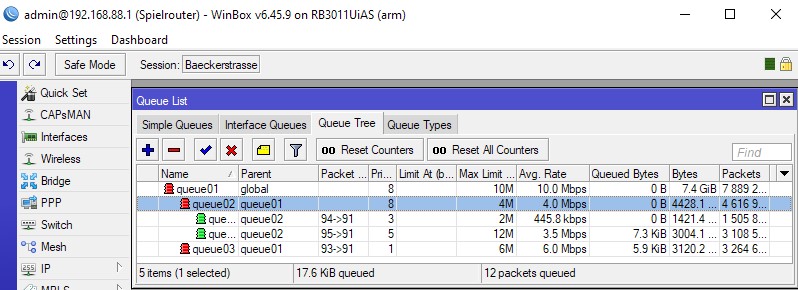

Here you see the behavior of the tokens as I expected, the example only with max-limit working:
Here you can see, queue02 limits the traffic of queue04 and queue05. They share the tokens of the parent queue02.

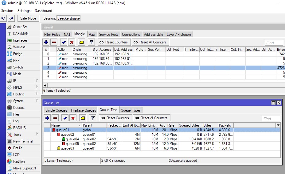

But, and this is misleading, with limit-at none of the queues limits the bandwith. Only an external interface does, not queue01:
You can see, none of the limits of queue02 nor queue01 does anything. The Avg. Rate of queue01 is 20Mbps, double the max-limit of 10Mbps. Same to Queue02, it means, the tokens are calculated from parent to child, and then the child produce more tokens for its limit-at - the child set the traffic. Or if you think, the traffic goes through every queue, you see that with a higher limit-at the parents get their tokens from the childs to fullfill the limit-at of the childs!!!
It surprised me, because the example implies for me queue01 would limit then, but it doesn’t. Only if there is a hardware interface with limit 10Mbps, the example works. It does not work only with queues.
