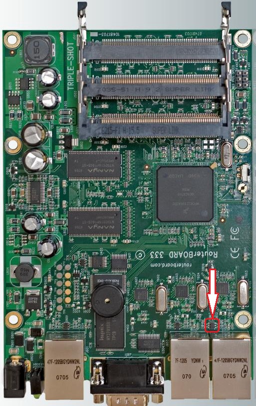

Good day! Please, help me.
After the storm was burnt chip on the RB333. Marking - L5. Please tell me its specifications for the replacement, otherwise the port is not working.
Thanks in advance!
Thanks in advance!
Carefully unsolder this chip, and test if the Ethernet starts to work. It’s also possible that the port itself is damaged.
Thank you for help! I did it, but get no results.
In that case, damage is bigger than just one chip. it’s possible that PHY KSZ8041 is damaged, replacing it could fix the issue, but it will be quite complicated.
