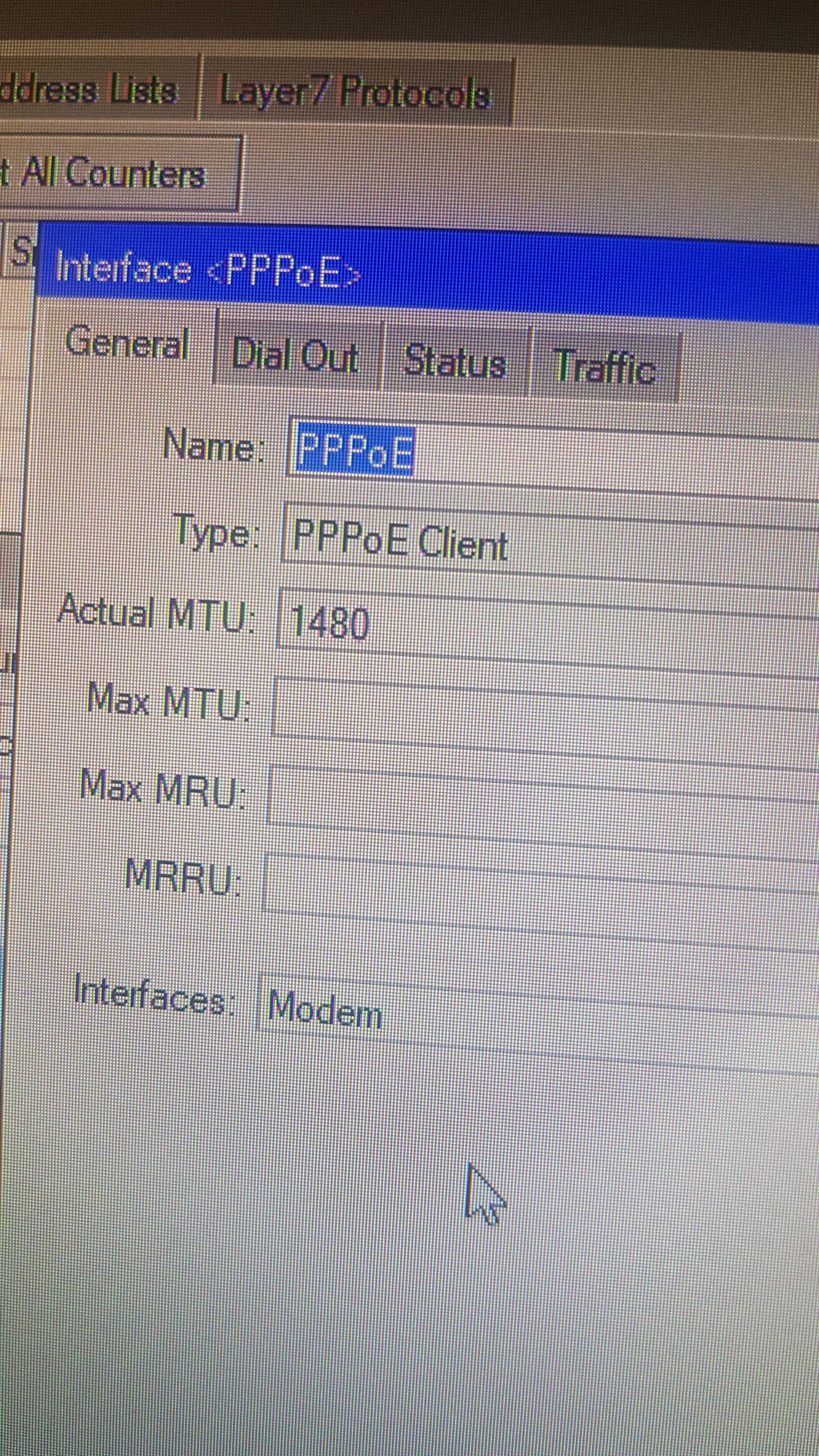

Hello how are you? I have a problem with changing the MTU of the Router, by default the MTU of my PPPoE Client comes in “1480” and the LAN and WAN in “1500” What I want to do is put my MTU in “1492” But I can’t change it in The PPPoE Client, When I try not let me modify it, how is it possible? Thank you
You can not set max MTU?
If you create a new PPPoE client, before saving, can you type in the max MTU field?
When I tilt my head far far enough I see as interface Modem and may have other rules as a ether interface.
Exactly I do that but in windows it still shows me an MTU of 1480 and not 1492

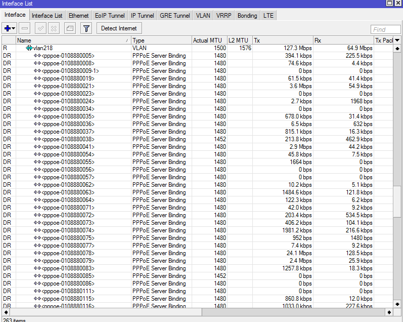

I have seen that actual MTU is coming for some of my customers are getting 1480 and 1452.

You can set the PPPoE MTU, but you don’t type it in where it says “Actual MTU” you type 1492 into “Max MTU” and “Max MRU”
The way MikroTik works with its PPPoE clients, if it can’t successfully carry the requested size (or you don’t enter one) it will drop back to 1480.
Even if the line can carry 1492, it will still drop back to 1480 unless you manually type it in
I could already change the MTU, the problem was that when I reset the router it loaded the initial configuration and did not leave it at 0, I did a reset and the first time I opened it I put in removing configuration and then I changed the MTU, Thank you all for answer.
