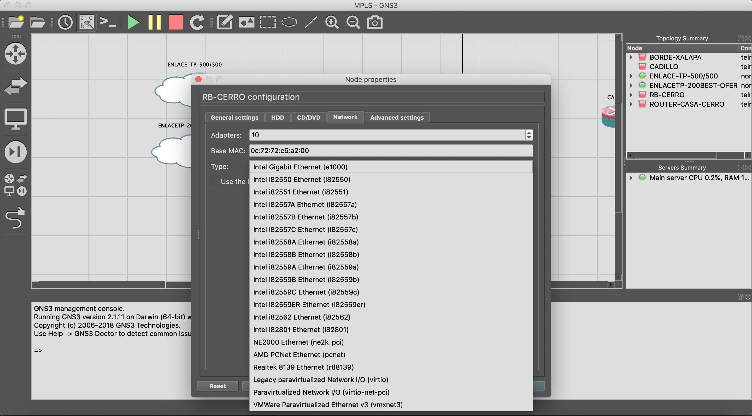

the solution is to change the default configuration of the ethernet interface that comes by default virtio-net-pci to some intel or realtek interface I recommend using intel gigabyte ethernet (e1000)
Kudos to the quoted guy. I could not for the life of me get RoMon working on CHR’s, once I changed from virito-net-pci to intel everything is working flawlessly so far. I’m just wondering if there is anyone that can shed some light on why the virito-net-pci driver doesn’t work?
