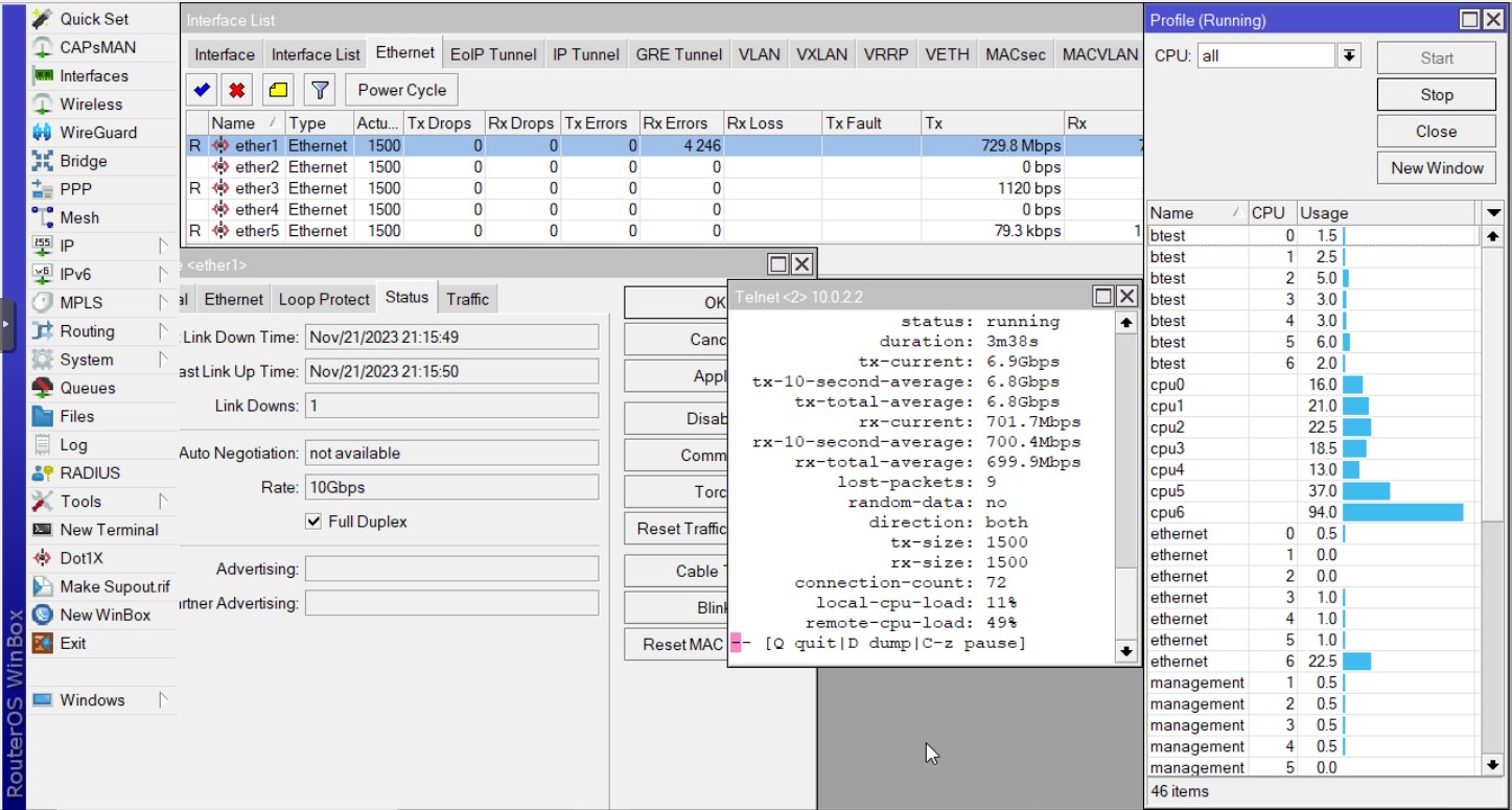

The problem is that when I check the balance of the vcores from the “Profile” tool I see that there is always one that shoots up between 80 to 98% and the rest remain at an equal average between them.

What kind of workload is going on when you see one vCPU load rise towards 100%? If you’re, by any chance, running bandwidth test (the ROS own tool), then what you see is inconclusive. Bandwidth test is known to cause huge load (on any platform).
Dear mkx, thank you for your response and sorry for my delay in responding, a lot of work.
I attach an image with the “Bandwidth Test” tests.
As you say, the consumption of this tool is excessive and “if it passes the test, it will surely not have problems in production XD”
My question refers to the fact that, in this case, the “cpu 6” shoots up to more than 90% while the others maintain prudent consumption.
Doing the same test in reverse, the CCR maintains its cores in similar ranges.
I know that Tile and x86 are, so to speak, “Oil and Water”, that’s why my question is if the behavior I have on CHR is normal or do I have to check some extra configuration.
Test data:
1- Everything happens in a laboratory.
2- CCR and CHR have a direct fiber connection with mikrotik SFP+ modules (S+85DLC03D).
3- I connect via telenet to CCR 1072-1G-8S+.
4- I run the bandwidth-test from the CCR, making the CCR send 7Gbps of traffic and the CHR return 700Mbps.
To finish you will see that I have “Rx Errors” and “lost packets”, that is what my second question was about…
Could it be that the connection is degraded by having a CPU that consumes too much?
As if it were a bottleneck.
Cordially.
It’s a pretty well known fact that ROS internal bandwidth-test tool is pretty CPU-heavy (single CPU bound) and results of it are hardly representative for device which is actually running it.
If you really want to assess the performance of your setup, you have to use external test probes (such as a couple of performance machines, running iperf3).

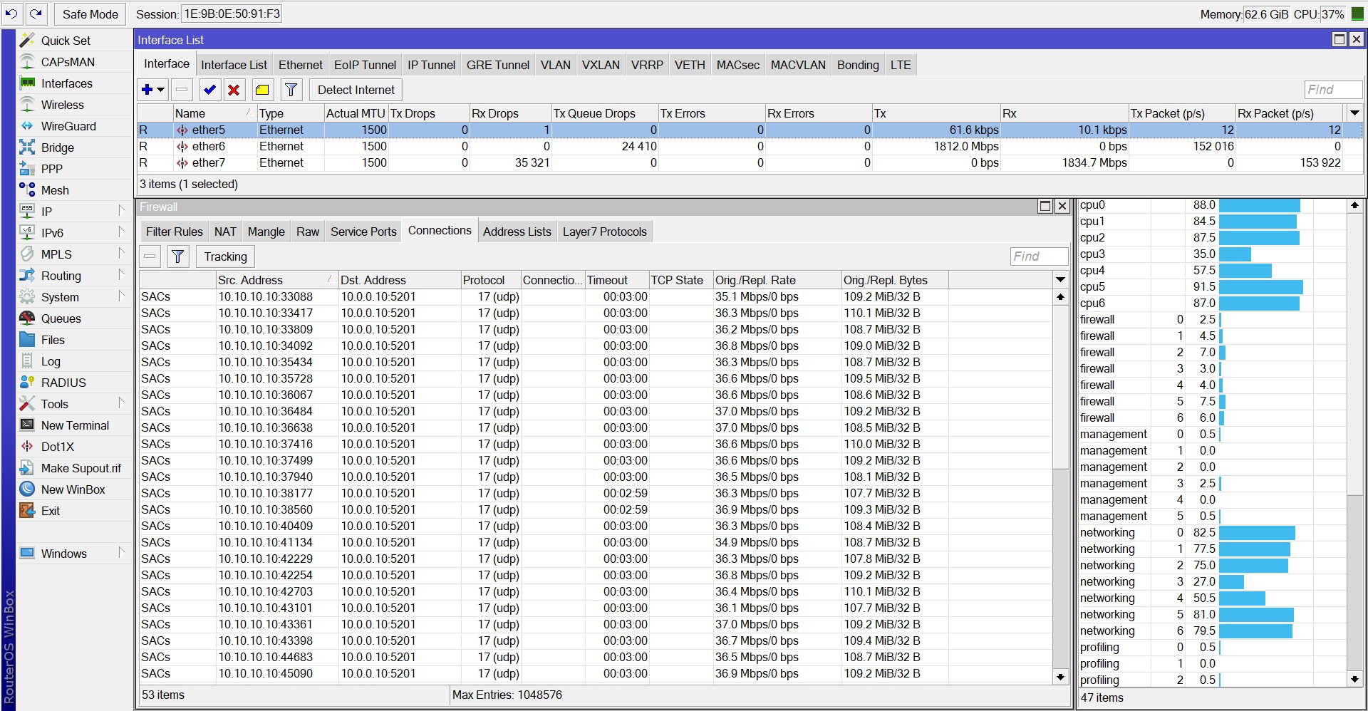

OK, so here goes another experience: ROS will use single core to deal with packets, belonging to same connection (either real TCP connection or “apparent” UDP connection). The reason being to avoid out-of-order packet delivery (which upsets some TCP stacks). On devices with larger number of slower cores (primarily CCR1xxx) this will cause bottleneck for single-threaded connection throughputs.
However, if there are multiple connections (can be between same pair of client-server), the load will spread more evenly between all available CPU cores … ant that’s many times the real-life scenario as well: number of concurrent users connecting to number of internet servers.
So when doing iperf3 tests, always conduct both single-threaded tests as well as multi-.threaded tests (using “–parallel N” command line parameter … and set N to 8 or more).
Another hint: TCP throughput is bound to two-way delays and sometimes throughput gets lower than expected (even if considering RTT and the rest of unknowns). So just to measure raw speed, it’s sometimes good to perform UDP tests. If the results are considerably higher than TCP results, then it’s worth to investigate the reason. Sometimes it simply boils down to timing issues which can’t be remedied by router settings (but it’s good to know if there are any such issues present on the network).

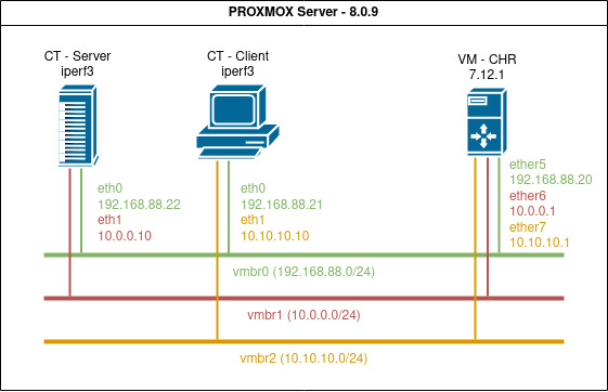

I attach an image with the layout of the current laboratory.
As you will see, everything is done within the same proxmox server.
I’m waiting for my new NIC “10 Gb Hp 560sfp Dual Port Sfp+ (Intel X520)” so I can take the lab to something closer to reality.

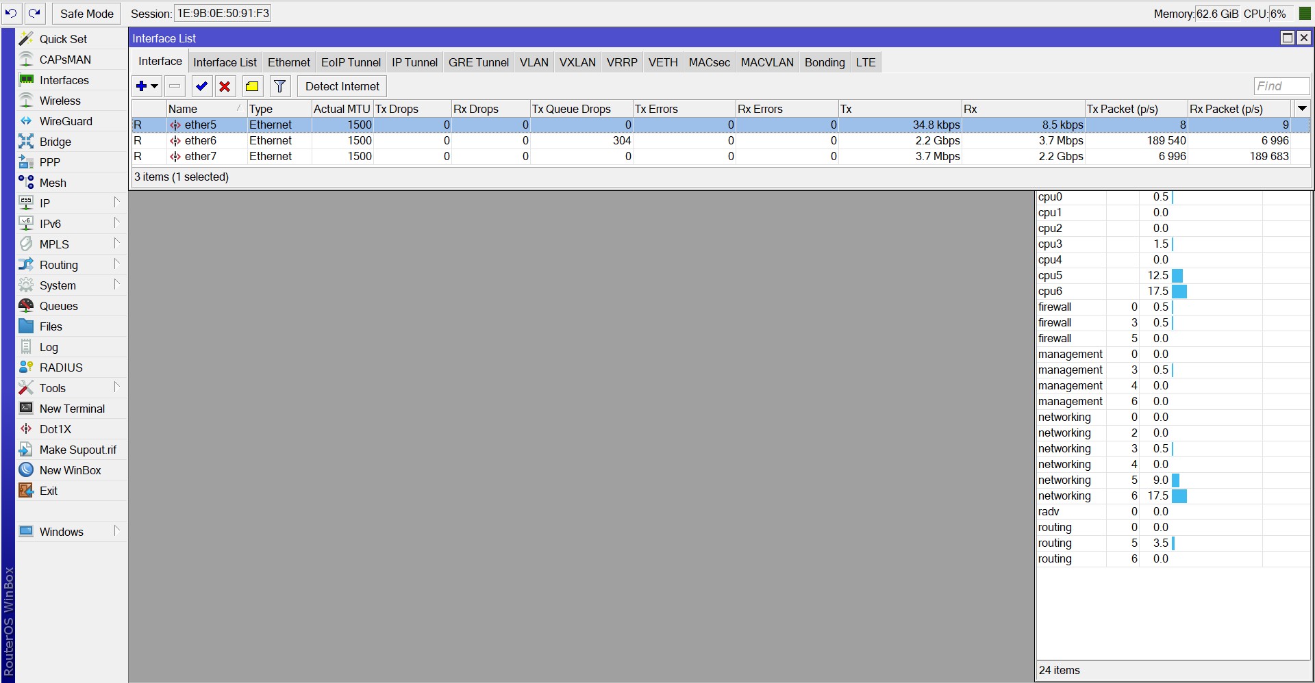

I attach my results because CHR behavior improved and CPU consumption decreased drastically. Even in these conditions where all interfaces are virtualized within proxmox in three bridges.
I decided to make CHR route traffic from one network to another to make it more interesting.
I attach the results of the tests in TCP:

I attach the results of the tests in UDP:
UDP trafic – 50 connection – 20M bandwidth
–COMMAND:
iperf3 -c 10.0.0.10 -f g -t 60 -u -P 50 -b 20M
Client - - - - - - - - - - - - - - - - - - - - - - - - -
[ ID] Interval Transfer Bitrate Jitter Lost/Total Datagrams
[SUM] 0.00-60.00 sec 6.98 GBytes 1.00 Gbits/sec 0.000 ms 0/5179550 (0%) sender
[SUM] 0.00-60.03 sec 6.98 GBytes 1.00 Gbits/sec 0.177 ms 0/5179525 (0%) receiver
Server - - - - - - - - - - - - - - - - - - - - - - - - -
[SUM] 0.00-60.03 sec 6.98 GBytes 999 Mbits/sec 0.177 ms 0/5179525 (0%) receiver
UDP trafic – 50 connection – 40M bandwidth
–COMMAND:
iperf3 -c 10.0.0.10 -f g -t 60 -u -P 50 -b 40M
[SUM] 0.00-60.00 sec 12.5 GBytes 1.79 Gbits/sec 0.000 ms 0/9261200 (0%) sender
[SUM] 0.00-60.03 sec 12.3 GBytes 1.76 Gbits/sec 0.309 ms 119344/9260418 (1.3%) receiver
–“Tx Queue Drops” in “ether6” = 51938
–“Rx Drops” in “ether7” = 54611
I’m not sure why at more than 1.5Gbps UDP starts to cause problems.
Will they be Linux bridges?
Could I be doing something wrong in the iperf3 parameter configuration?
Well that’s what I have until now when the MIC arrives I’m going to make the traffic travel over real physical interfaces and with that get closer to a real production environment.
Cordially.
When UDP iperf3 test shows transmitter to fall lower than configured total bandwidth, this usually means bottleneck on the transmitter itself - that’s the only place UDP throughput is throttled without packets being dropped.
