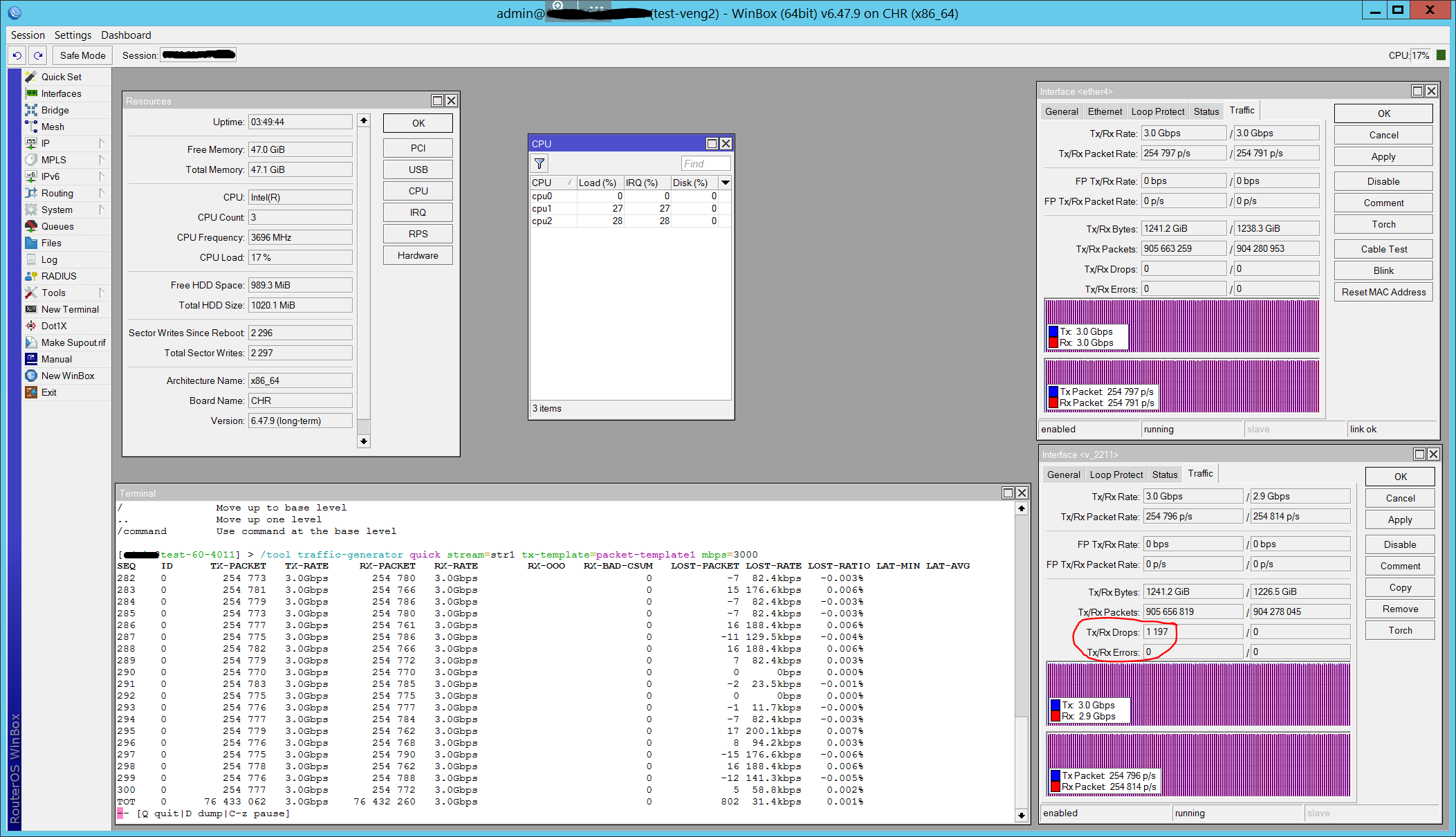

As soon as you push any load over about 2Gbps the VLAN interface starts to clock tx-drops. The parent interface does not. The higher the traffic load, the more drops and the more unstable the CHR instance becomes.

edit 1: my imgur links didn’t work. Uploaded the images instead and placed them inline.
