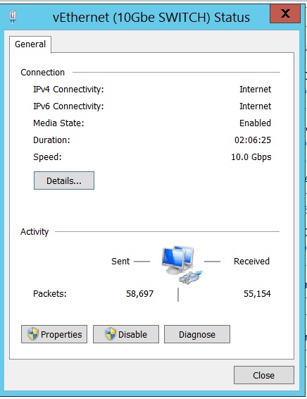

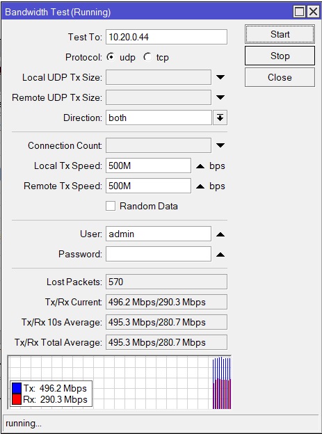

How do you managed to get the CHR Interface recognize 10GB speed on the HYPERV?
I installed 1 Intel X540 dual 10GB PCIx card and when i bandwidth test it only reaches to almost 500Mbps and 300Mbps from CHR to other Mikrotiks that i have with 10Gb Connectivity
I have attached print screens on this message.
