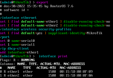

https://imgur.com/a/RFvQ4ne
Yep, only one interface exists. It seems to be connected to whatever is first in the HyperV VM settings. In this case it’s the bridged adapter so I can get into it with Winbox, but second interface (that is connected to a Private adapter) and 3rd, disconnected one, are nowhere to be seen

Just did a quick test with ROS 7.6 VHDX 1st gen VM on server 2016.
Assigned 2 network cards and fired it up. Both interfaces showed up.

https://i.imgur.com/xuvyUUH.png
