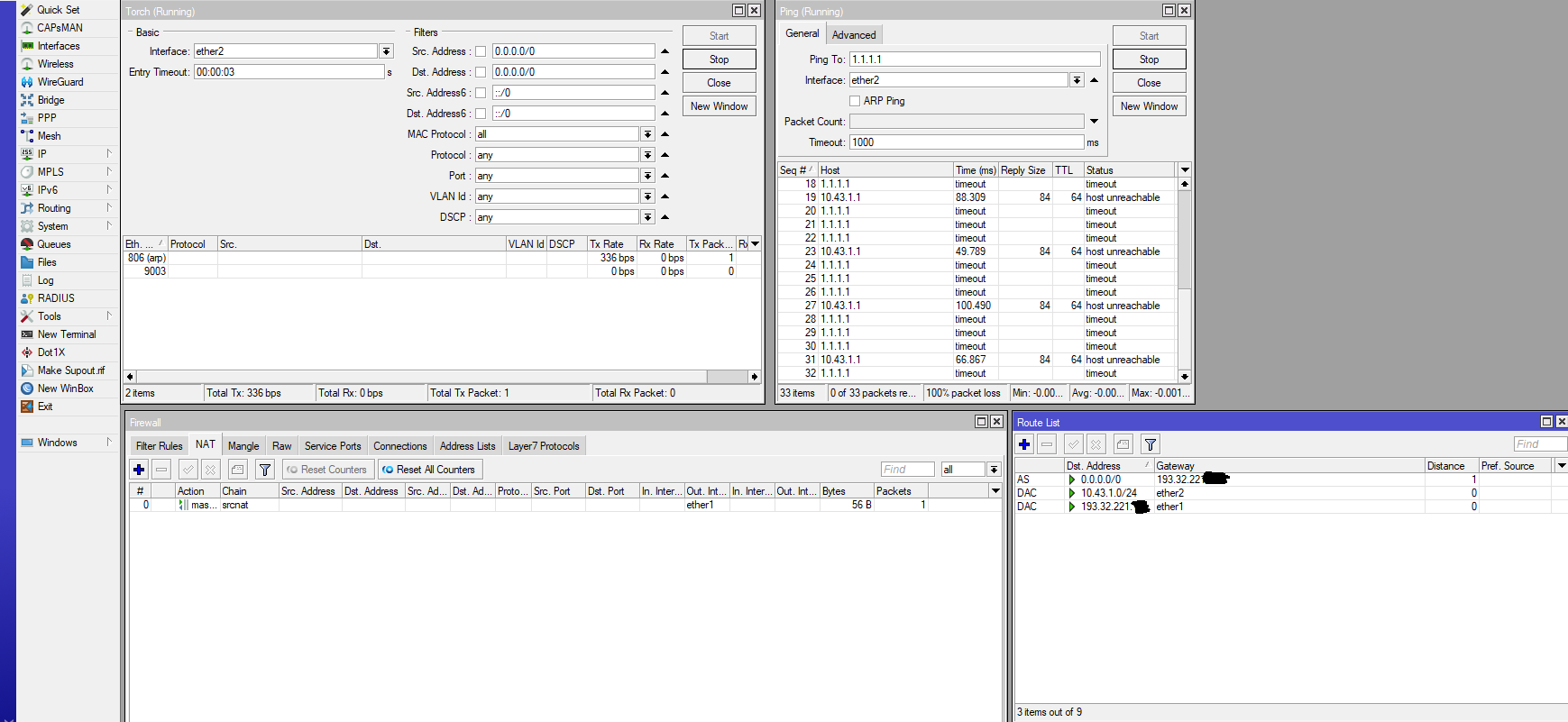

Ping and Torch on the CHR:
picture attached.

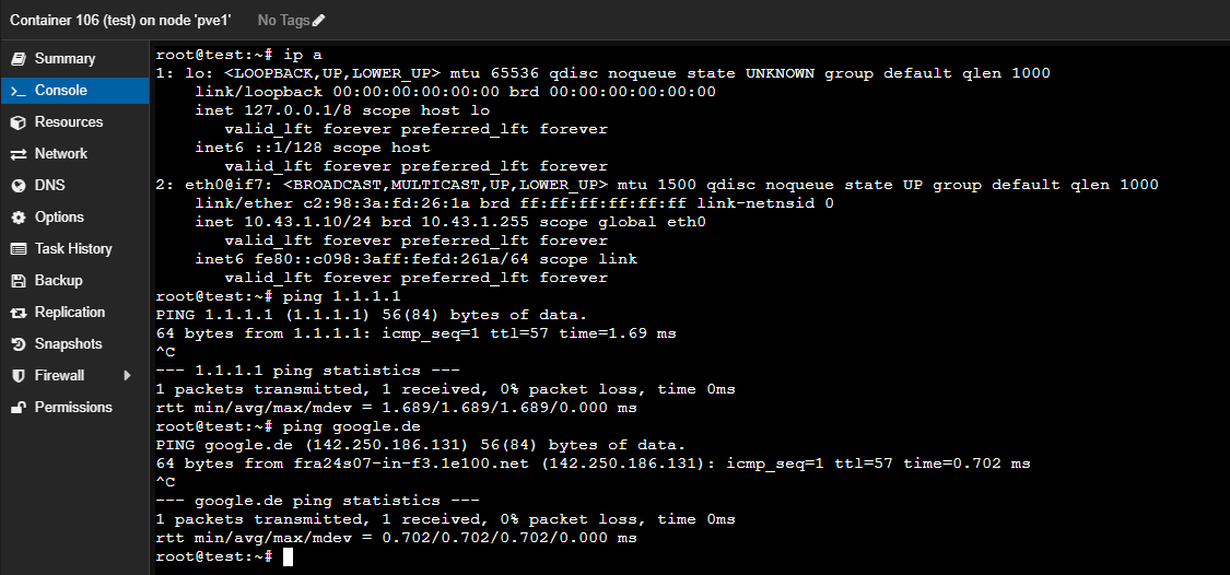

Test LXC Container in the LAN:
picture also attachted with ping and traceroute checks.

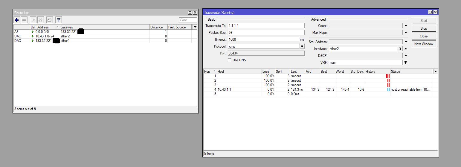

Traceroute and routes from the chr:
