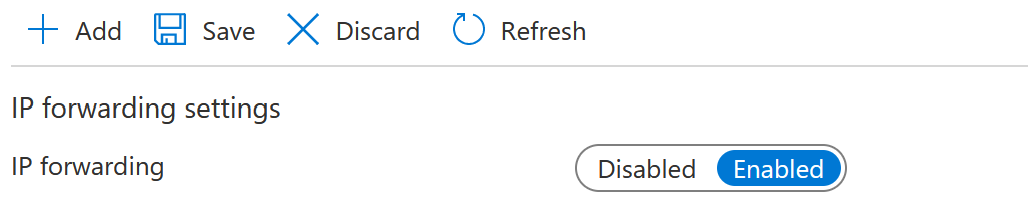

Did you enable the IP Forwarding on the Mikrotik CHR VM NIC?
I didn’t know about that before
After I kept failing I googled some more and enabled that, still did not work, so I rebooted the VM and went to sleep.
Will test more today.
You need to add a route table to that subnet in Azure and add custom routes. The route type must be virtual appliance and the gateway is the Mikrotik private IP address from the subnet!
