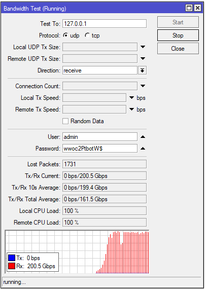

On your CHR , perform a btest to 127.0.0.1
127.0.0.1 is a local interface on the CHR server.
On one of my slowest VmWare ESXi servers ( Xeon 2-something GHz with Hyper-Threading ) running a CHR doing a btest to 127.0.0.1 , I get over 200-GIg.
I am getting 250-300Gbit/s for such tests.
This is how it looks when I remove speed limit:
CPU usage during this time:
So I have to use queues to limit speed to 4-5 gbps and for getting stable bandwidth without huge drops.
