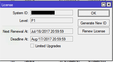

I’ve bought a P10-perpetual license for CHR. The license is visible and assigned to my CHR with the proper sytem-id xxxx within the license portal. It even updates the “Last Seen” value continuously, but the CHR still shows me the installed license as P1. I tried to perform a license renew on the router multiple times, but it simply won’t fetch the new P10 license from the portal.
I’m wondering if there is any option to reset the current license on the router, so that it fetches the new license from the portal?

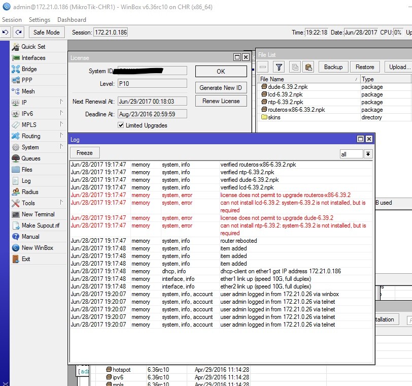

Here is what I got back from support !
:frowning:
Please use newest version (6.36rc version is the old one).
Install 6.39.2, then your CHR will be licensed properly.
Best regards,
Sergejs
MikroTik.com

Is the checkbox “Limited Upgrade” checked or not?

It’s not checked.
If memory serves me right that means your license ia applied :slight_smile:
