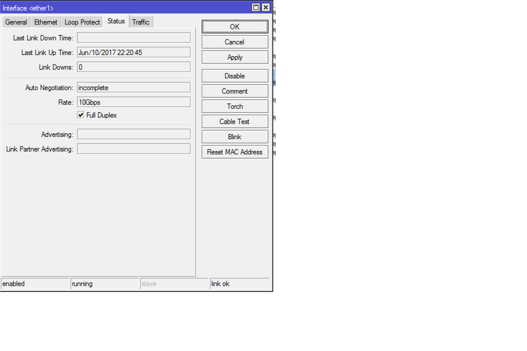

I’m running CHR on VMWARE, with licens P10, I’m having an issue when using a vmxnet3 network card, the card shows up as 10Gbps but says “incompatible”. Now, despite that not having a direct performance impact on the interface, and being able to get 10Gbps just fine. There seems to be an issue with DHCP when running on a bridge.
When an interface is slave to a bridge it seems that it doesn’t respond to DHCP client requests.
I cannot get an IP from DHCP when on bridge. When I put the dhcp server on the interface directly and disable the bridge then it works right away!
