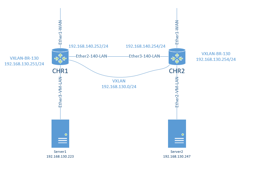

I am havind troubles with a VXLAN setup between two datacenter servers which are connected together via internal datacenter VLAN on a 192.168.140.0/24 subnet.
I am running ROS 7.8 on CHRs on both sides with HyperV.
See attachment for setup-overview.
Problem is the following:
Server1 can ping CHR1 (192.168.130.251) and CHR can ping Server 1(192.168.130.223)
Server2 can ping CHR2 (192.168.130.254) and CHR can ping Server 1(192.168.130.247)
CHR1 can ping CHR2 both on 140.254 and on 130.254 when VXLAN interface is active, when down only on 140.254
Same the otherside
Problem is, the servers can’t ping each other… Server can’t ping router on other side aswell.
What is goin on here? I tried so many vxlan configuration options: On interface, without interface.
