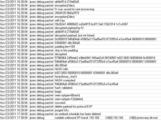

Yesterday I checked the box “Generate Policy” and after that it was almost up for 24 hours!
Unfortunately the vpn died at 17:18 today and got back online at 17:30 when my scheduled flush ran.
Nothing in the logs as far as I can see, attached.
