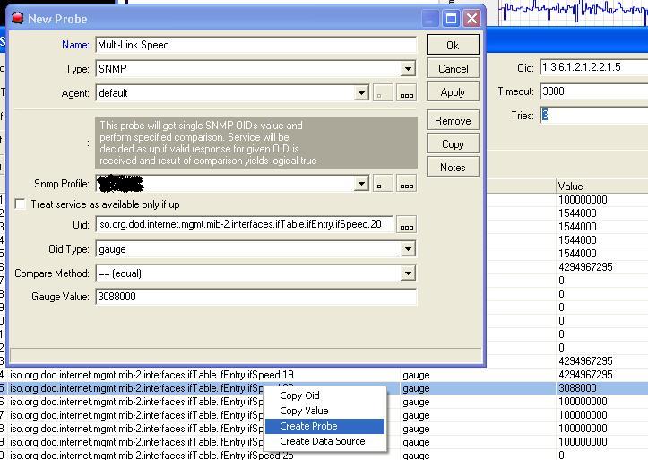

I know this is the solution you provided as “worse case scenario” but I only have 2 multi-link routers. For the many gigabit Ether channels I hope to find a better solution… Like you were trying to find the oid that shows how many links are in an Ether channel and so was I but I still haven’t found it :frowning: I figure I am missing some mib at this point since the command “show etherchannel summary” shows you the ports in a channel it should be exposed by a mib somewhere.
Anyhow here is how to make a multi-link probe. And like you said the OID can change from a reboot so you might have to fix them… Search the oid and create a probe and assign that probe to just that device.
Works like a champ. I really don’t want build a bunch of individually named probes!!!
Here you can see that I shut down half of a multi-link. I renamed the probe with the device name in it but I took the screen shot before I fixed the probe…
Now to get it working automatically BLEH :slight_smile:

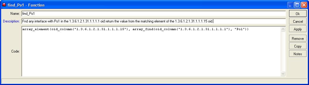

Ok I think I have it although it will probably be a little snmp intense… Although I now think the snmp reads might be cached.
With array_find we find that Po1 is in some element in the array, With array_element we use the element returned from the find to extract the value from another array of OIDS since both arrays have the same number of elements.. IT WORKS :slight_smile:
Create a function called find_Po1 and put the code below.
array_element(oid_column(“1.3.6.1.2.1.31.1.1.1.15”), array_find(oid_column(“1.3.6.1.2.1.31.1.1.1.1”), “Po1”))
As a test place [find_Po1()] on a device label and you will see the array_element from the function.
You would need to create a function for each port channel you want to find.
So now to make a probe… I will look at this more later.
