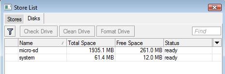

There used to be about 30 MB of free HDD space out of the 61.4 MB, which was plenty for uploading a new firmeware for upgrade. Now something happened and the free HDD space is only 12 MB. Under Files there are only about 100 kB of data listed.
To free more HDD space I went to Stores / Disks and pressed the Clean Drive button and the message “All disk data will be lost! Clean anyway?” appeared. I pressed yes and the following error message appeared “Check Drive Error - cannot check/format system disk (6)”.
How can I free some more HDD space?

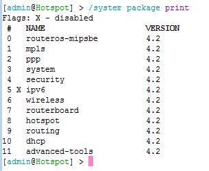

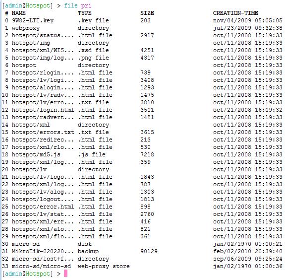

What do you have in /file print and /system package print?
Hello Sergejs
Here are the requested data:
Since submiting my post I upgraded to v4.2. The behaviour is as before.
I think you can download backup file, disk space for upgrade should be available after it.
